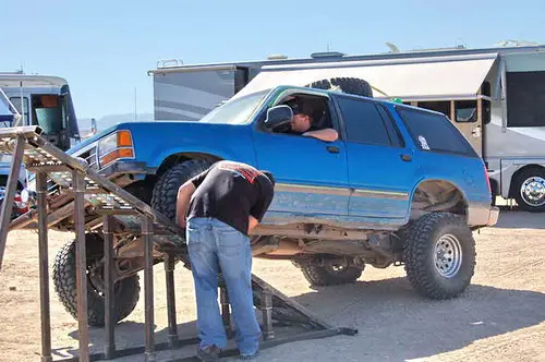

Here are a couple shots of our X showing its flex through the different mods..
Duff lift (3.5" springs with spacer) with duff brackets

Duff lift (3.5" spring with spacer), f-250 shock mounts and extended RA (using Ballistic Joints instead of RA bushings)
truckhaven-57 by maniak_az, on Flickr
and
truckhaven-55 by maniak_az, on Flickr
Duff springs (3.5" + spacer), Cut turned beams, f-250 shock mounts and extended Radius arms.
Truckhaven-mlk 2012 -5 by maniak_az, on Flickr

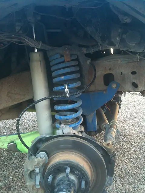

Here is its latest. Now using 6" skyjacker springs, cut/turned beams, f-250 shock mounts and extended Radius arms. Its about the same flex as it was with the Duff springs EXCEPT we get more droop since the spring is longer.
I know all the pics aren't of the X doing the same thing so the flex amounts isn't quite the same (heading uphill like on the last pic means you get less stuff since there is less weight on the tire), but you get the idea.

The duff 3.5" springs with spacers worked really well for me but I wanted more. Since the spacer wasn't a spring, it meant it wouldn't droop as far as it could if I had a long enough spring. Same for stuff, the spacer doesn't compress BUT, we could already hit the airbox with the tire at full stuff.
Also, Keep in mind, the Duff spring is a progressive rate spring and it rides much different than a constant rate spring. We were getting much more initial travel from the duff spring. The Current springs (skyjacker) make the front end feel more planted at speed.
The Skyjacker springs I have up front now are a little stiffer than I want (400+ ppi IIRC). I'm going to see if they soften up with some more miles/wheeling but I don't think they will. I will probably end up switching to some non TTB springs that are in the mid 300's ppi.
If you don't want to deal with drop brackets the cut/turn will let you run the lift without using drop brackets, but if you already have drop brackets I don't think the cut/turn is worth the extra money for most people.
The f-250 shock mounts is a must if you want more flex. Otherwise you just can't get a long enough shock in there...
Same with the extended RA. You don't need Ballistic joints on them but you really do need extended RAs to get nice flex.
