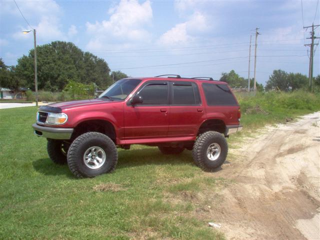

theres no way u can fit 33s on 3in of lift, ull cut so much of your fender it will look hidieous, i have the 4in superlift suspension on my 99 on 33s and i had to cut a good amount of the fender, the only way to clear 33s with no problem is to go 4in suspension and 2in bl, maybe a 5in but u may have to trim a little
3" Spindles and 2" TT(You could do 3+"but than your gunna have alignemnt probs and youll need adjustable uppers) along with a SOA in the back and 3" Body lift for total of 9"s and fit 35"s nicely
