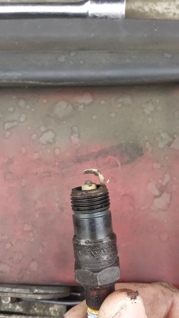

Update: I received my air temp sensor and coolant sensor in the mail today. after some cussing and all that they have been changed. The ambient air sensor was coated in what looked like varnish so that could be it. The coolant sensor was coated in green sludge so that could be it too. Needless to say I will now have to wait a day or two and try to start the car to see if changing those out did anything. Next on the list if these dont resolve it will be the MAF/TPS/IAC for good measure. I sort of went through the wires while doing this and all look good from what I can tell.
