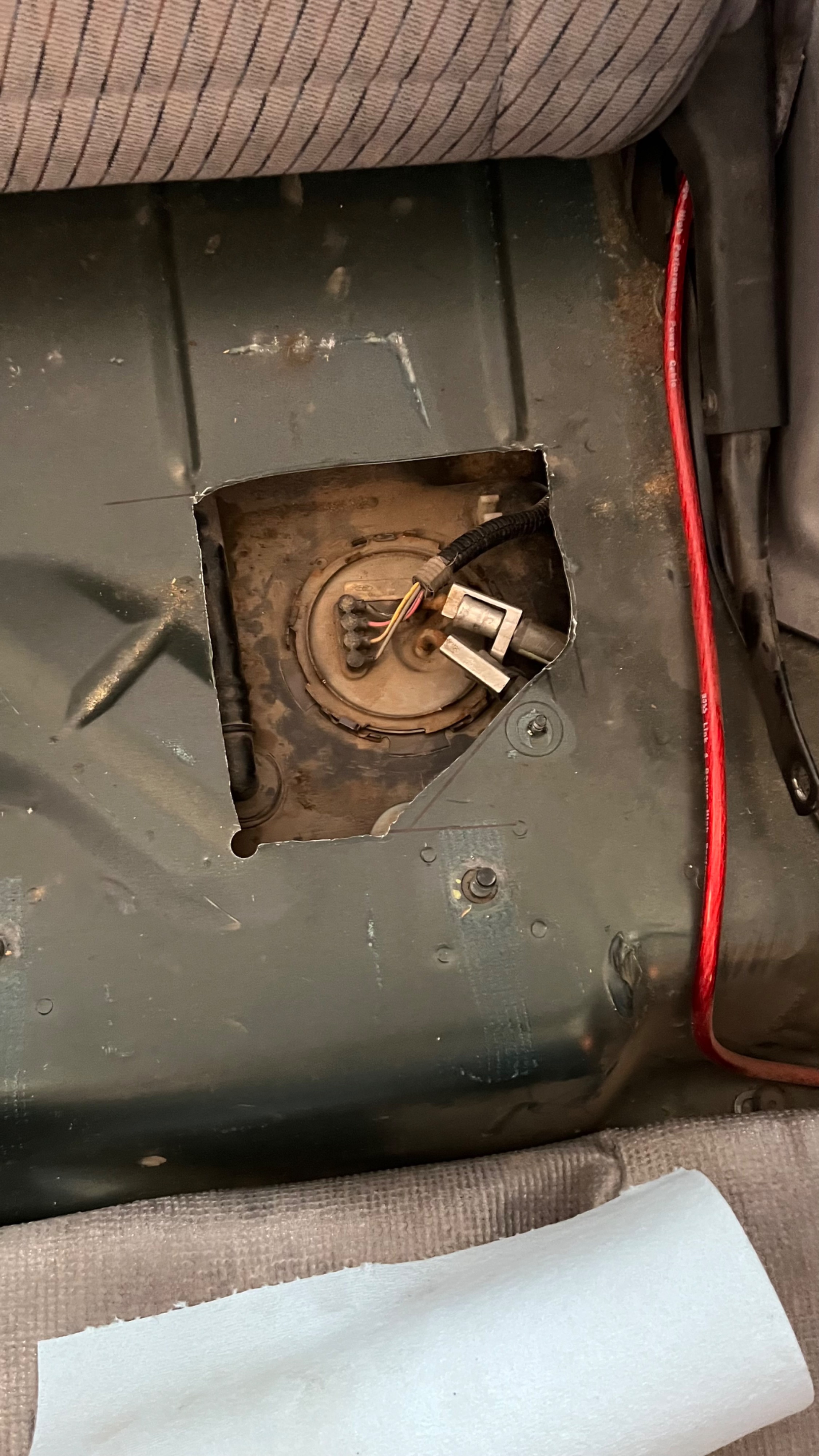

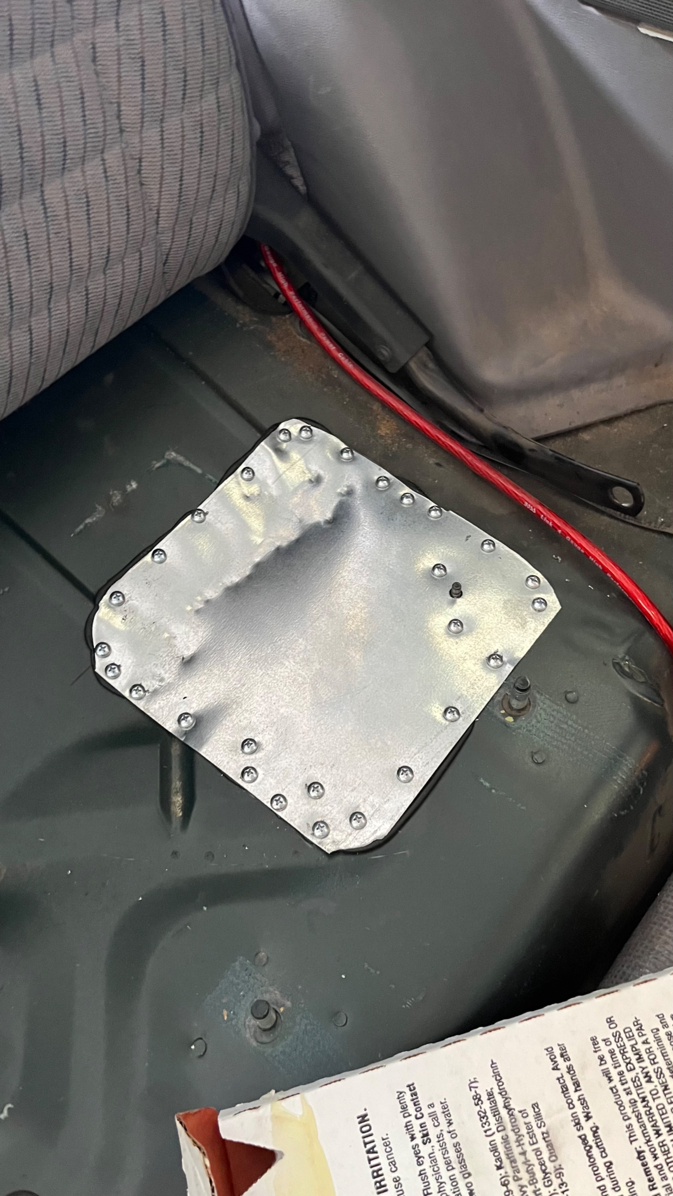

Looks like I got the fuel gauge issue sorted out. Didn’t feel like dropping the tank so, cut an access panel under the rear seat. Found a $20 nibbler that attaches to a drill. Made cutting the hole super easy and no sparks.
Looks like the float was getting caught on the power wires for the pump. Rerouted them in a different spot and used a few extra zip ties. Couldn’t get a picture since I didn’t pull the fuel lines off or the pump hanger out all the way. Made a quick patch panel and sealed with butyl tape and self tappers.
For anyone wondering the maximum rated cutting thickness, 1.6mm is 14 gauge.
