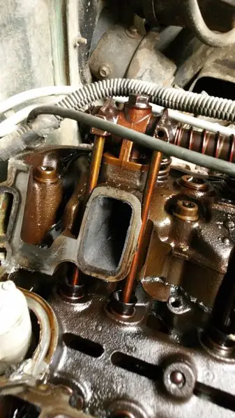

Alright well I had the intake gaskets so I'm throwing them on. Found carbon buildup on the pushrods on #5 & #6 cylinder. The rest are clean. Is this a sign of an intake leak (a bad one at that)?
#4 (normal)
#5 (carbon buildup)
