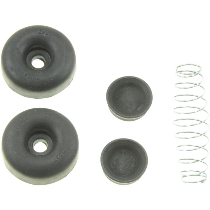

...This week I had more time than money so I bought a wheel cylinder kit for a 94 X to stop the river poring out of the pass rear wheel...The parts were close but different so it was a waste of time but it did almost stop the leak...:rolleyes:
..AZ PN# 66820...

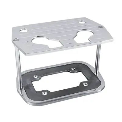

...I went to a couple huge ricer shops out here today figuring they surely would have a billet or decent racing over the top only hold down for an Optima 34/78 redtop, but no luck...:thumbdwn:

Something like this:
...I would be more than happy if I could find just the top piece of the Arizona one and bolts to the stock battery tray..
I've got the optima to stock hold down adapter you can have.
Here's one for a little less money.
Optima Battery Hold-Down
He used to make them without the spider thing cut in the top bracket. When I order one, I am going to request no spider (I guess I'm not 16 anymore...)
...I appreciate the offer of their stock hold down but after my accident and seeing how the bottom holder failed, I am set on a top hold down and plan on this mod for all my future trucks...
...The X's battery popped out and the negative post was a mere fraction away from shorting out on the starter solenoid...:eek:
...I have seen the hold down you posted online for $110-$150....I really like that set up as I plan to use the GM post for accessories power and would be concerned with the ones I posted scarfing a wire...:dunno:...Just a little to expensive for me...
...Now if you have one of those just laying around for cheap, I can be down there ASAP and I'll even buy the taco's around the corner...:salute:
...Scott, that's the cheapest one I've seen yet...:biggthump...You would think that So Cal would sell these all over the place...:rolleyes:
Edit: I just saw that Ballistic has one for $39 bucks but I wonder if the bottom tabs will fit in the stock tray...:scratch:

Ruffstuff has one for the same price:
Anymore I'd say don't order from Ballistic, unless you have 3-4 weeks to wait on them.
....Thanks for the heads up and I like that box as the fasteners for the top bracket are out of the way of the front cables and are located up top...
...and here is their link as they say they will be adding more styles...
http://www.ruffstuffspecialties.com....html?osCsid=a118aef38763670310f81cf6f4d4c8a8
...It is definitely looking more affordable and with choices so I won't have to be rockin the new bungie cord mod for long...:rolleyes:
...Thanks for the help Gentlemen...:salute:
I like the RuffStuff piece - and the price. If you get this one, let me know how you like it.
Just need to figure out what color to powder coat it...
...I'll let you know what I wind up with, possibly a group buy??
...Rattlecan FTW...:biggthump
