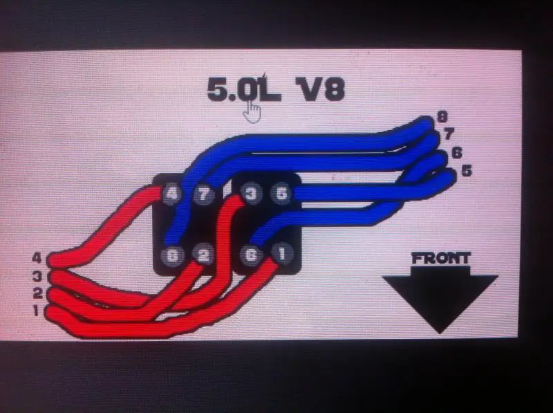

Double and triple check the coil pack wiring order. Those are easy to mix up when swapping the wires over. That can happen when replacing the wires, or the coil packs. Check those very carefully, and the connectors/wires plugged into them. The wires are old and fragile, be gentle with them always now.
firing order 96-01 5.0
Thanks Jamie, that's a great picture of the timing order for the 302 coil packs.
