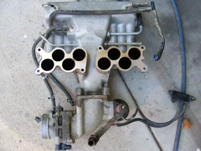

Another issue is the PCV Valve. It is sitting there whistling like crazy, it has a hose attached to the rear side , facing the rear of the engine, but the side pointing at the front of the engine has nothing attached. Is there a hose connection I cannot see under the plenum, a cap? Thanks for any advice.
Here is a view of the upper intake's bottom side
In the upper right hand corner you can see a plastic t connector which is in the shape of an "F" , 2 vacuum lines and the pcv valve
Both of those lines provide the PCV vacuum. Hopefully this view will help you to get it reconnected.
