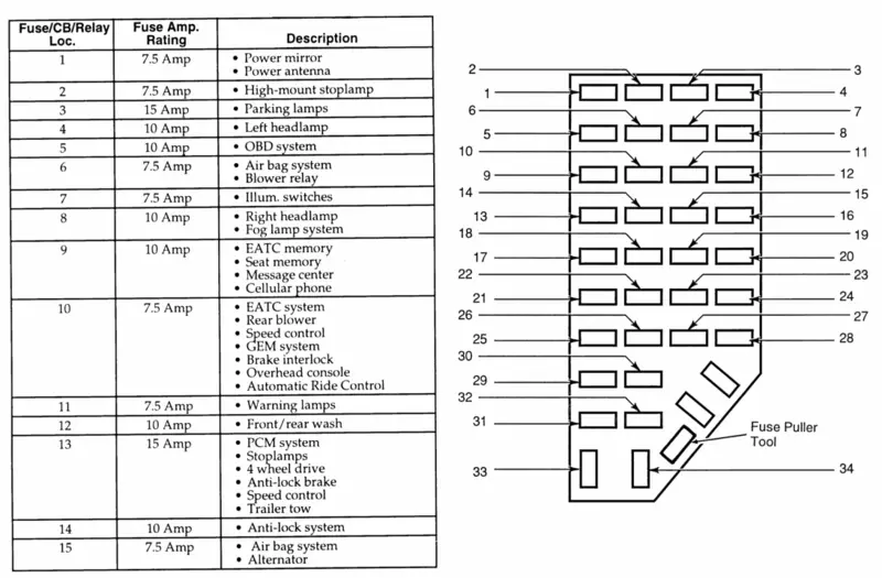

Okay, looking at an older ('96) fuse diagram, I see that #13 is not just brakes (which I mentioned in my prior post then edited out because it was wrong info) but rather a 15Amp, PCM system, stoplamps, 4 wheel drive, anti-lock brake, speed control, trailer tow.
The question in my mind is whether one of the above is drawing too much current or the fuse contacts were in bad shape from another cause. If it's the former and now soldered together, it'll just take the same event to put you back worse than you started.

This pic is from the '96 manual but I just checked the '97 and fuse 13 handles all the same things. I'd take this to the fuse box to see if the rest look correct in placement and current rating, not knowing what other antics the shop might've been up to.

Based on that manual it looks like a shorted stop lamp bulb would cause that fuse to blow.

Ooops - made a careless mistake. This is fuse 19 in the interior fuse box which covers: radio nose capacitor, ignition coil and PCM power diode.
