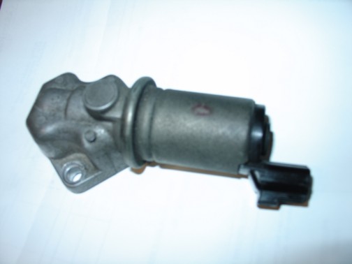

the valve body portion of the IAC should not go bad, the solenoid portion is all that you need to ever replace...
Mine is a one piece part.
Please explain the above statement.
OH they changed the design, sorry :) the older IAC's or at least the one on my 5.0L and my 4.0L OHV are two pieces, the solenoid comes off with two phillips screws.
The valve body section is just a plunger and spring, should never need replacing, I have $20 says the older style will bolt up and plug into your SOHC too...
