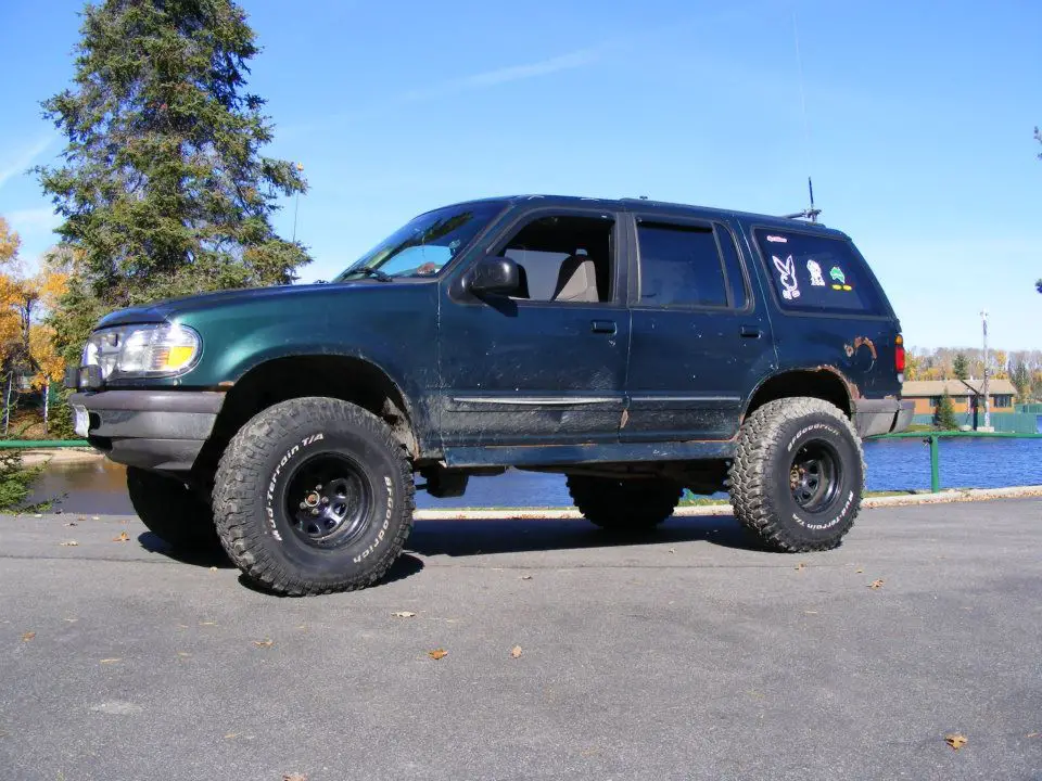

fair enough, we put a body lift on our second gen, with 35s and it goes EVERYWHERE..

How do those cv axles do with those 35s? Lol but I was thinking 33s would be good enough for me so maybe a body lift ain't a bad idea

35s will be hard on lots of stock items. With tires that big you need to off road with your head, and not the skinny pedal.
35's stock driveline,, daily driver,, with rear locker,,
with normal driving and spraying it down at the car wash i still have the same parts 5 years later ;)
I'm pretty surprised haha, I don't have a real heavy foot I like to creep but climbing hills is fun so I'd probably go with 33s as the tallest on stock shafts. I have 31 mt's now and it does great but I have high centered it and the rear bumper took some good hits on some rocks haha I gotta say tho I'm pretty impressed with it and it helps having a manual with 4low and 4.10s
