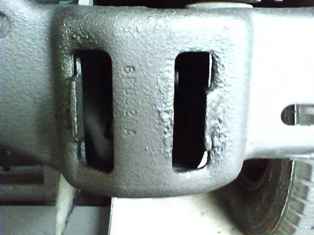

I doubt it will get it hot enough.
In the rare event that I bend them back I use an acetylene torch and it takes a few mineuts.
Glowing orange is the best adn easiest condition to bend them.
crap, i dont have an oxy/acetylene torch, nor access to one...
i also dont have the $ to buy the new horns either...... this sucks, and i need this fixed asap, htis is currently my moms only vehicle... she is riding buses right now....
do you have an aftermarket source to those frame horns? i need cheap as possible, local dealer said $256, torrie @ fpn wants $160..... but i am still poor as hell
looking at mine, think i can bend them back with a bench vise, and being creative? without removing them?
i have the knowledge to replace them, but not the fundage....
it would be a heck of a lot of work to bend them with out heat.
You wont do it by hand at least.

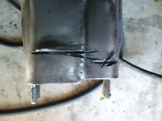

ok, so i am borrowing a big air compressor to tackle this.... my grinder is 3" and should i be using a 1/16" thick wheel or a 1/32" thick wheel?
so i am making a little progress..... i decided to use a 3" x 1/32" wheel
after the deed, i hit it with a wire wheel to show details.... i cut into the rail a hair here and there, but never through--so i think im good... i will probably grind off the rest of the welds so it is smooth after i do some positioning of the new parts which arent here yet.... i will also be only doing one side at a time to use the other for comparison... i do also have a used bumper i will be using for mockup that is straight just to double check it
what do you think?
WOW !!!!!!!!!!!!!
That is one clean jop !!!!!!!
Very impressed.

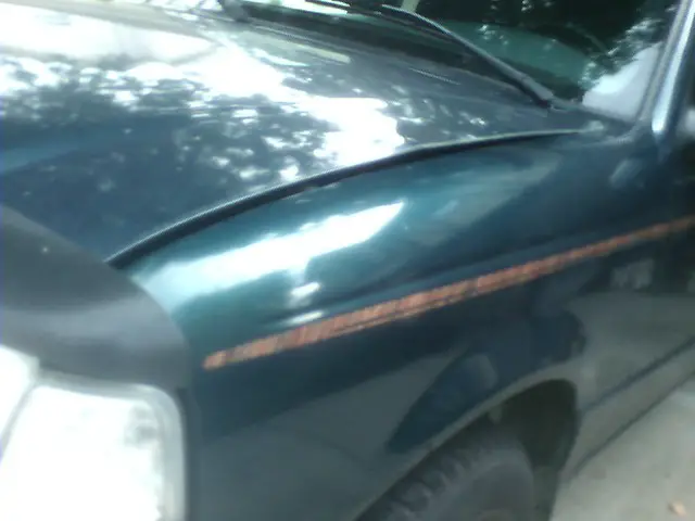

i am done with it for now.... i ended up getting the 4x2 grill.... i really should replace the hood and replace the front core support, but i have not yet. here is what the pics show, i have stacked nuts to space the hood latch mechanism out to where it's supposed to be, also the hood is a hair up from being smashed, and you can see the feders are wider out at the front than the back, die to the sore support being bent in, so they spread.... and then.... here is the finished product... it is noticeable, but, not too much..... i still need to attach the front license plate bracket though....
