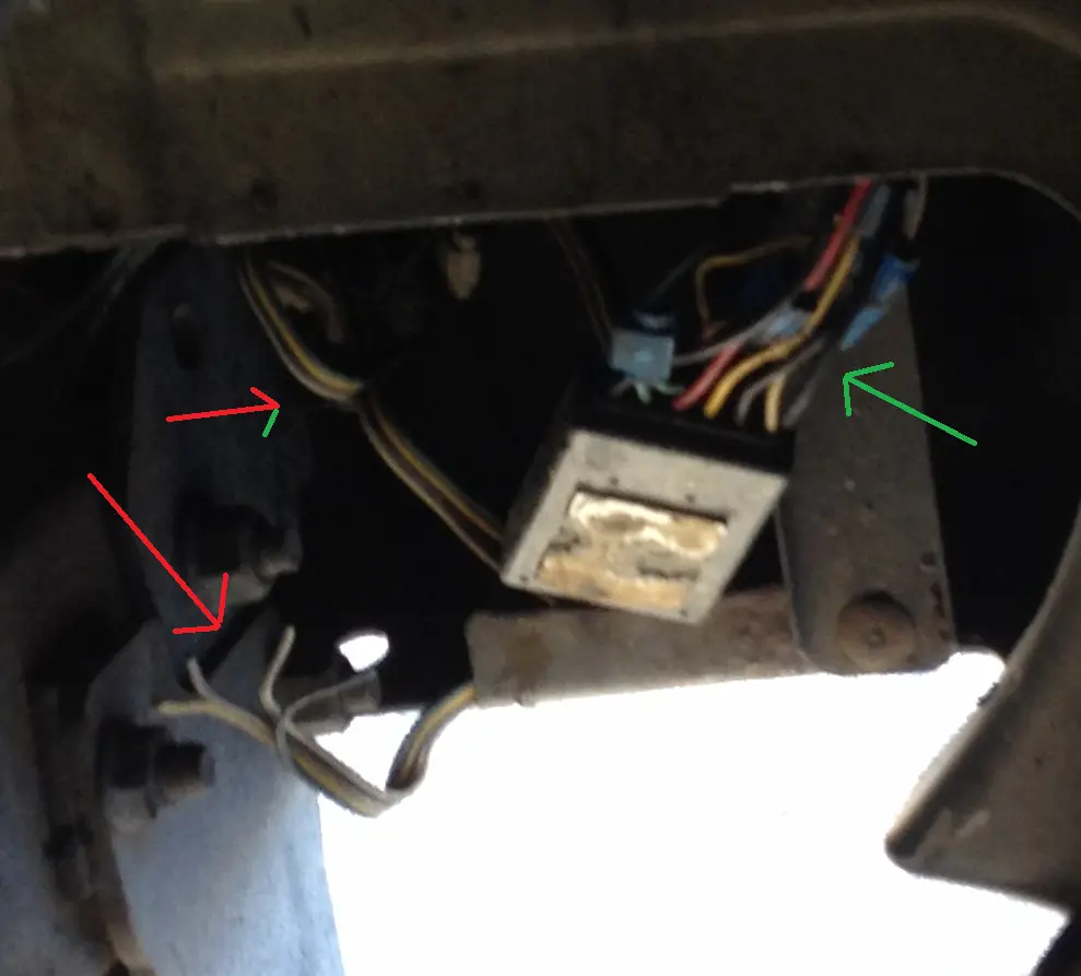

I then moved on to my trailer wiring. There was nothing immediately apparent that would indicate that something was wrong. What I did notice, however, was that the wiring junction box was in the perfect spot to get sprayed with water from my driver's side rear tire:
I wanted to cut out the entire trailer wiring harness, but it looked like some kind of factory deal. It was wired right in with the light sockets and the junction box itself had a ground wire right to the body, no splicing or anything that would indicate an aftermarket installation, so I left it alone. After further investigation, I found where the box had previously been attached (glued or something) to the body, directly behind the driver's side tail light. I shoved it back in there and used a zip tie to hold it in place, and after more wet roads and snow, no blown fuse.

There is no obvious way to disconnect this box. There are wires coming straight from the tail light sockets to the box, and the box does not appear to unplug in any way. I would have just cut it out if it wasn't integrated with everything.
One side of the box has input wires coming from the tail lights and wiring harness. The other side of the box has the wires that used to go to the trailer plug, but I took that off a while ago. Recently I trimmed the wires that went to the plug down just about to the junction box but that was more cosmetic than anything else, they weren't bare or anything.
Red arrows mark the wires coming from the box that used to go to the trailer plug. I only put 2 arrows to show that they are the same wires. The green arrow points to the wires that go from the tail lights to the junction box. (Ignore the green part of the first red arrow)
Edit: the wires I pointed to in red are the ones I chopped off just after this picture.
