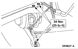

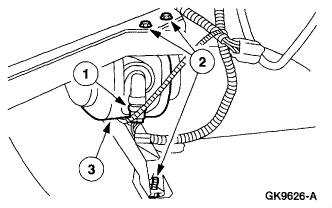

Here is how you do it ............
Remove the fog lamp assembly.
1 Disconnect the fog lamp bulb electrical connector.
2 Remove the bolts.
3 Remove the fog lamp assembly.
If necessary, transfer the fog lamp bulb to the new fog lamp assembly.
INSTALLATION
WARNING: THE HALOGEN BULB CONTAINS GAS UNDER PRESSURE. THE BULB MAY SHATTER IF THE GLASS ENVELOPE IS SCRATCHED OR IF THE BULB IS DROPPED. HANDLE THE BULB ONLY BY ITS BASE. AVOID TOUCHING THE GLASS ENVELOPE.
NOTE: The fog lamp bulb should not be removed from the fog lamp until just before a replacement bulb is installed. Removing the bulb for an extended period of time may affect fog lamp bulb performance. Contaminants may enter the fog lamp where they can settle on the lens and reflector. Never turn on the fog lamps with the bulb removed.
To install, reverse the removal procedure.
