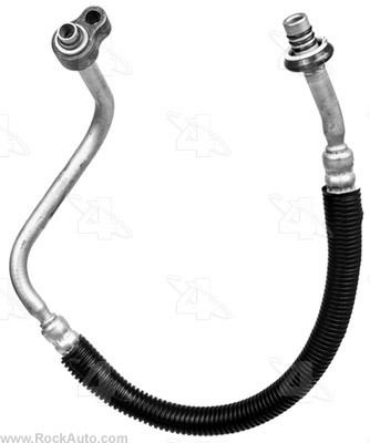

i have a 98 xlt 5.0 and he high side is very close to the clutch and i refilled the system today to have a tun of freon spray out.
its leaking from the pipe that connects to the a/c high side valve and connects to the clutch
THE PROBLEM IS THAT THIS IS CLOSE TO THE CLUTCH THAT WHEN THE CLUTCH SPINNS IT HIT THE LINE AND PUT A SLICE IN IT.
ANY ONE HAVE THIS PROBLEM? it dosent look like its out of place either looks as the pipe is suposto be there...
DOES ANYONE KNOW WHAT THAT PIPE IS, SO I CAN ORDER A REPLACMENT?
this pic is the closest thing i could find to what it looks like but it dosent look rite
thanks
it attaches to the high side circled in the pic

if i take a poxy stick (supposto be "strong as steel" which is stronger then aluminum of which the pipe is made of) and patched the slice would it hold?
http://www.mclendons.com/item.asp?sku=10070750
No. Get a hose. You won't like it...it's an expensive hose. The part number you want is Motorcraft YF2524. Aftermarket is available. But the Motorcraft hose comes with all protectors, switch, clamp, etc. Worth the money.
You're the man!! I have been searching for this part number for a few hours!
