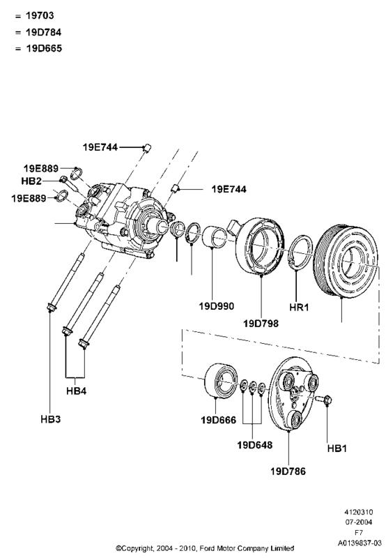

Since it's hot outside, I wanted to bump this thread. I'm sure that it will help a lot of people. I just did this job on my 1995 van yesterday. I'm going to provide more information on removing & installing the clutch with diagrams.
  • 1995 Ford Truck Aerostar 2WD 3.0L MFI 6 cylinder repair guides. Compressor clutch & field coil.pdf
  • Compressor clutch removal & installation..pdf

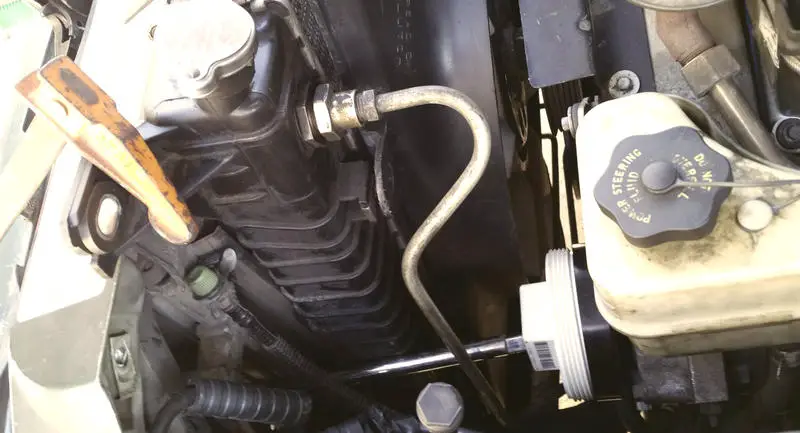

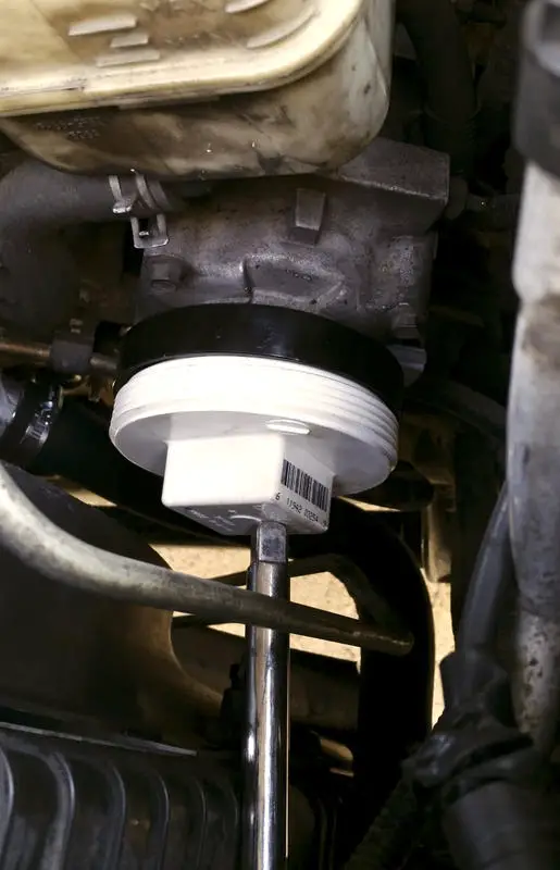

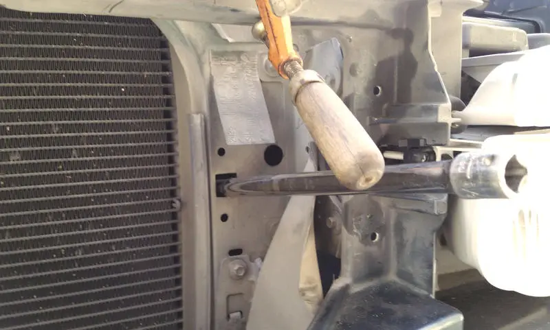

Thanks for the info. I just finished doing this on my '97 (without removing the compressor or opening the system). The trouble I had was getting the coil completely seated without the bolt stripping/breaking. I was able to get it pressed on within about 3/16" of where it was supposed to go but that's it.
I found a way to gain just enough access to it from the front of the vehicle through an existing hole in the radiator core support. I placed a 4" PVC clean-out plug on the coil assembly and used a long 1/2"-drive extension and a few light taps with a hammer. This drove it the rest of the way on to the compressor. Had to first pull the grill and loosen the radiator to do it, but here's how:
--mike

Great tip! I've fought with that one myself.
