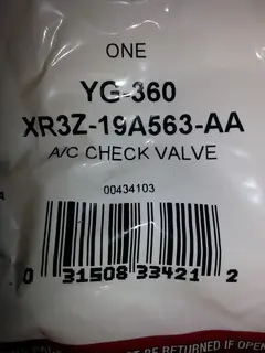

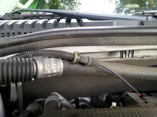

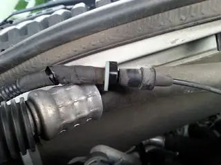

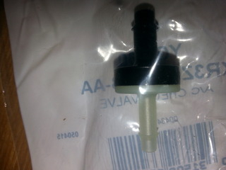

Fixed my vent problem with the new check valve. I consider myself lucky. I bought the generic brand check valve from O'reilly's. I think it was $4 or $5. I was using a dowel created from a wooden spoon, which worked.
Fixed this with a new vacuum check valve. No guesswork.
Purchased for $10 here : http://www.rockauto.com/catalog/moreinfo.php?pk=380402&jnid=2&jpid=0
It is located here:
Just pull it apart and replace it with the new one installed in the same direction and its done. 5 minutes including the test drive.
Purchased for $10 here : More Information for MOTORCRAFT YG360
It is located here:
It is located here:
