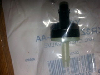

Fixed this with a new vacuum check valve. No guesswork.
Purchased for $10 here : http://www.rockauto.com/catalog/moreinfo.php?pk=380402&jnid=2&jpid=0

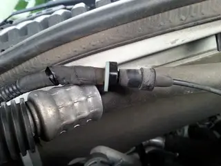

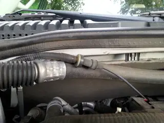

It is located here:
Just pull it apart and replace it with the new one installed in the same direction and its done. 5 minutes including the test drive.
