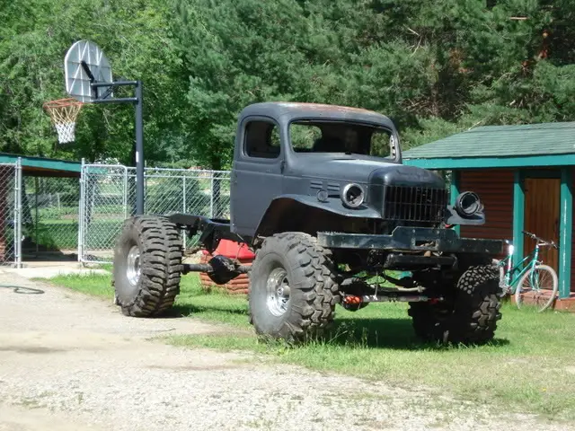

A couple pics of my project.
I needed a new steering shaft (mine was totaled) so I went with Flaming River PT# FR1518-1DD. It was expensive, but it was well worth it. It is a hardcore piece of engineering that is way overbuilt. That part # is intended for F-150's and as such the two piece shaft needs to be trimmed substantially to fit in a stock explorer. So if you need something longer, that's the ticket.
If you would like I'll post pics in the morning, for now it is off to bed.
Very cool project. If I show this to my wife, she might divorce me just for thinking!!!
sub'd. Can't wait to see more. But I'm confused. with the big tires, it looks like you're making an off road machine. But, with a chop top? I'm in, I wanna take it for a ride.
you got it....Im goin out on a limb and bein different with a chopped hot rod. It is going on big tires and keeping the 4x4.

Subscribing! I love the explorer rims in combo with the body. Dunno why, but it looks badass.
I agree the rims kinda fit the look. But the only problem is those tires I traded for are 16's, So Im in the market for some cheap 16's to fit the bolt pattern. Or i might end up buying some new wheels from summit or someplace.
So I found some cheap 16" wheels off of a jeep. They are currently wrapped in 265/75/16 geolandars, But the 285 open countrys will get on there sometime. Atleast the truck has a more truckish set of tires on it now. :) Cab and fenders are about in place and I hope to get to modifying the rad support and getting that back in monday.

Just a little update. Sorry no pictures since it still looks about the same. But I have chopped the front of the frame off back to just behind the rad support mounts. Moved the rad just over that cross bar about 3" in front of the fan, and dropped it down a bit to fit just under the top of the fenders. Made a couple mounts for the front of the fenders/grille. Thats about it for now. More work Thursday evening.
So is this going to be an off road car or like a hot rod or like a resto? I'm just confused because it really screams hot rod thus far because of the chopped roof , yet you bought like off road wheels for it so....
Offroad is the plan for now. It actually started out a street rod
but I missed going off road with my 4runner and I wanted a second vehicle I can go out and play and still have a vehicle I can drive to work Monday morning if I break something on the weekend. :) The chop top all started because I like the look. The truck being 1947 wasn't the most desirable hot rod truck with the front end it had, so I went custom. Also being where the streets are not that great and winter lasts bit longer than summer. I like something with a little more ground clearance than an air bagged hot rod. Besides how often do you see hot rods with big tires and 4x4. I like to be different. :)
