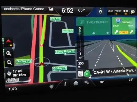

While on a route, I really like how the Nav shows the exit on the right side of the screen. From what I have seen so far, its very accurate to what the actual signs look like and read.....and it highlights the one brighter for which one you need to take........
