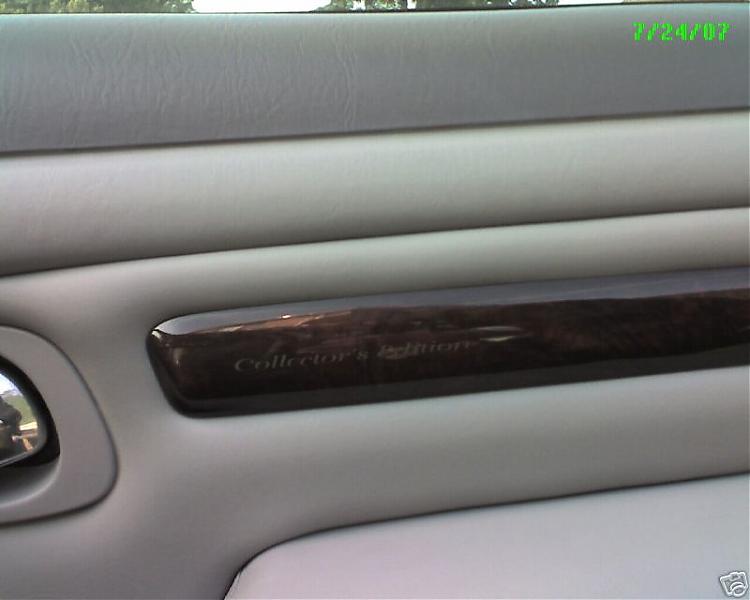

Hello guys, do you know how many of these two toned seats came in the Mark VIII's? I have seen two locally in a few years, both were red LSC's. I'd like to find a red 98 LSC some day, but I need to do something honorable with my red 91 Special Edition first. Regards,

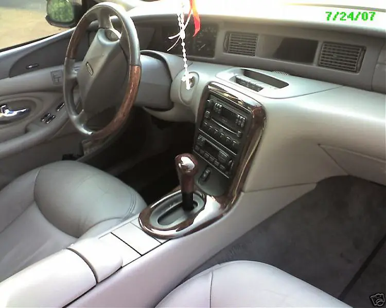

The two tone stuff came in the 98 collectors edition... if my memory serves me correctly.
There weren't many of them made and they are hard to find.
In that picture you see the "half wood/half leather" collectors edition steering wheel..they also have a wooden shifter knob instead of the leather one found in the other marks.
The collectors series cars were Toredor Red and Whatever the white/creme/oxford color is...
hope this helps
It does, but I need more space and time, before I could begin. Two project cars, one work vehicle, sell four or five, then I could start looking.
I had three pictures of this eBay car saved, I recall now that it had the Collectors Edition labeling. Thanks,

The half wood steering wheel sells for 500.00
the wooden shift knob also sells for 300-500.00 IF you can find one..

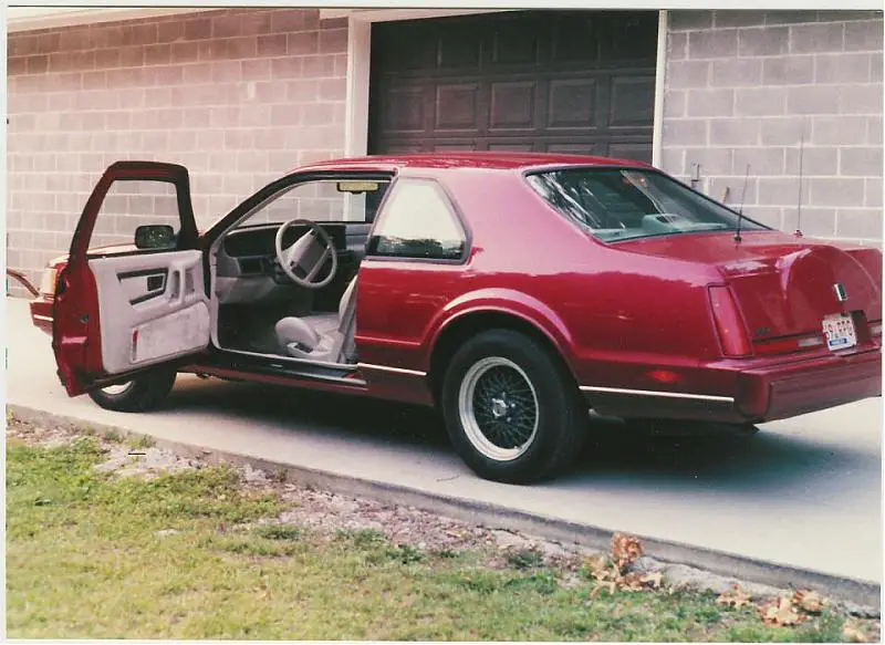

I miss my first 91 SE, it was so nice. I didn't realize how nice until looking for a replacement. Regards,
