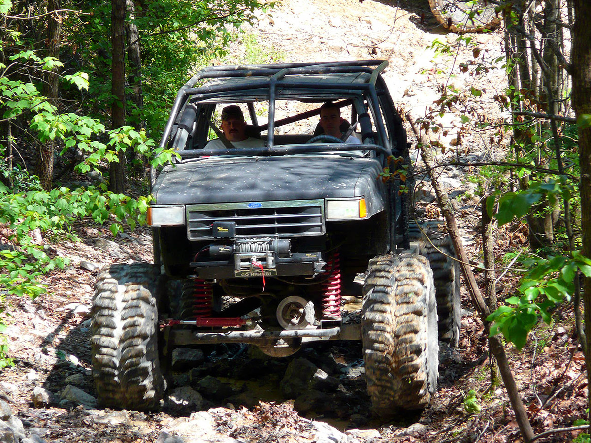

a couple more pics...
Thats what the hell I am talking about. Good lookin' out! Thats where I would like to go with the vehichle. Are those 44" Boggers? I used to have 'em on my old Bronco I had.
