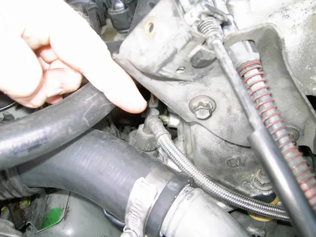

The fuel pressure regulator is on the engine, see pic for location on a OHV. This is not your problem. If the red button is on the switch at the passenger's feet, that is the inertia switch; also not your problem.
