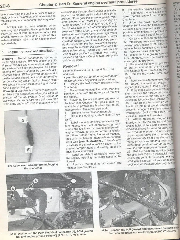

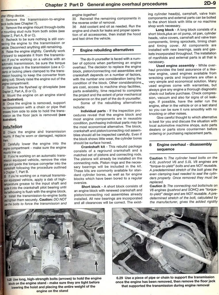

Here is one part of it Going to get the other for ya
I can get other info for you if you need it hope these pics help.
Sorry for big images but thats the only way you can read it clearly
