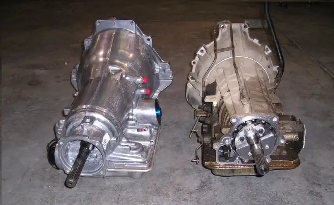

got the tranny in yet? if so how's it work? any pic's?
The tranny is built and at AA, but they are currently waiting on the adapters to install it. We are currently n the wait for fabrication phase again. It looks like the stock shifter linkage won't work without manufacturing some small and intricate parts to adapt the ford column shifter to the tranny. They are most likely going to go with an aftermarket floor shifter to allow for marketability. Those are the latest udates I have.

Okay, here are the first set of pics. The left tranny is the new 700-R4 and the one on the right is the old POS A4LD
