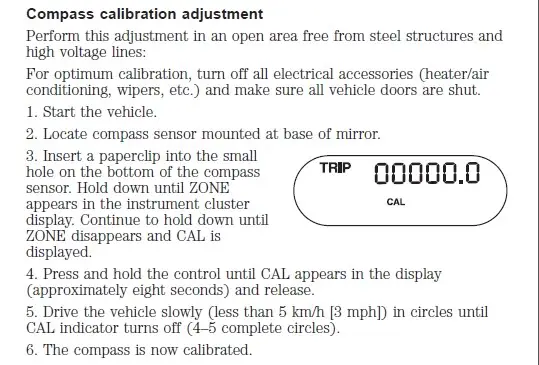

The direction indicator: your compass may need to be re-calibrated. The info on how to do this is in the owner's manual. If you don't have an owner's manual, Dead Link Removed.
Start by selecting the proper zone:
Then calibrate the compass:
Hope this helps out! :biggthump
