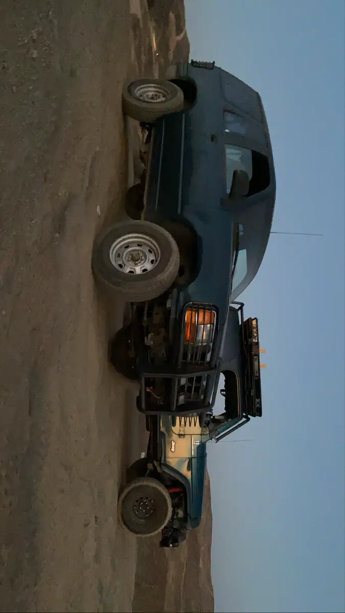

Took It to get it dirty last weekend and I want my ac to work this whole summer

A good working AC in a 1st Gen is rare! I've owned 6 or 7 of them and I finally dove into my current truck installing a new evaporator, and having a shop tie up all the loose ends and charge it. It's almost surreal, with my tinited windows, I actually have to turn it down in this 95+ So Cal heat
