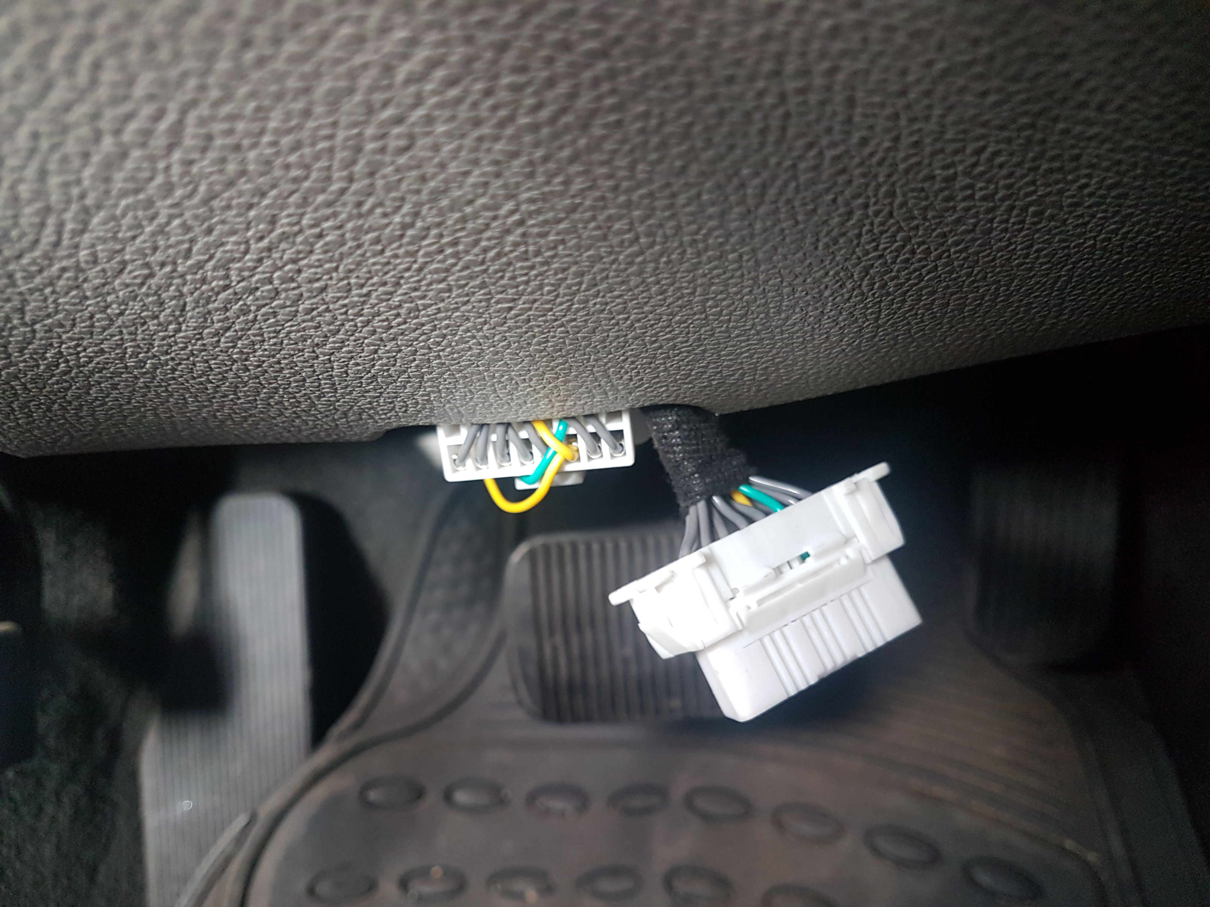

I have ford explorer 2015 XLT with manual power liftgate, just recently I installed aftermarket power liftgate (Power Lift Gate – Autoease) and its working absolutely fine. I have 5 button keyfob which I programmed yesterday... and this keyfob is working fine.. Its starting my car and already I installed remote start OEM from ford.. and its working.. however just tailgate not opening from the keyfob.. i am sure that I need to activate this feature from forscan.. it would be great if someone tell me how to do it because i am new to forscan and didn't try this software before.. I just backed up my As-Built data ... any help would be appreciated..
Also i want to mount dash button to open liftgate, can anyone here please guide me that which wiring should be done for dash button installation?
Update: I fixed power liftgate button.. i made the hole in the panel and fit the dash button, and gave connection to tailgate ... and its working perfectly.. also I installed foot sensor, now the liftgate is opening via foot sensor as well (just like in explorer 2016+), just one thing is remaining for me; liftgate is not opening from remote. I enabled the liftgate feature via forscan as well, but after enabling it from forscan liftgate doesnt work. I have 5 button orignal keyfob.. remote start is already there and its working from remote...
Any clue or suggestion anyone can provide to make it work via remote?
It’s an aftermarket system. Is it even designed to work with Fords CAN network? You have a link to the installation instructions I maybe able to see something in there. Depends on where the wiring harness connects and what to. If it doesn’t connect to the CAN system then it’s not going to work with the remote.

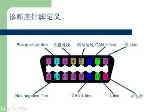

This is aftermarket system. Yes they have Canbus which is connected to orignal OBD PORT.
Please check attached images.
