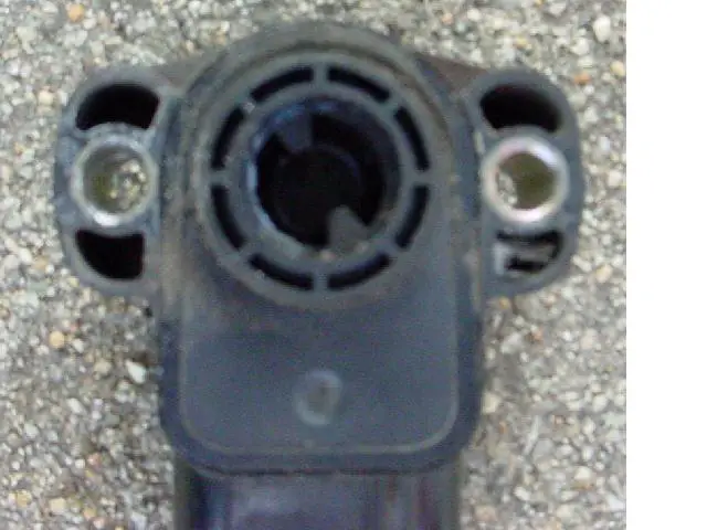

the TPS sensor is right on top of the throttle body. you will need to remove a few covers/brackets to get to it. it will have a small cover over it, and will have 3 wires. the small cover snaps off. here is were it is located on the 5 liter- [/B]
Mine wasn't on the top of the throttle body, it was on the left side. (Picture the TB rotated counter-clockwise 1/4 turn.)The hard lines of the air conditioning system made it a real b***h! But with the help of my brother I was able to finally get it done. The before voltage was 1.07. The after is is 95.4. I haven't taken it for a drive but the idle does seem smoother. I'll let you know how it drives later.
I used one of those small double ended screwdrivers with a 90 degree bend on each end. It wasn't easy but it made it do-able with my brother helping to hold the sensor in place. I couldn't even fit a stubby screwdriver in their! I also pressed as hard as I could to keep from damaging the screw head. Here's a pic of the screwdriver.Originally posted by Garth

What did you use to pull those screws, a long or short screwdriver? I was unable to get mine loose and it started to wear out the head of the screws.

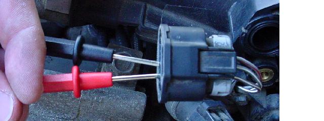

You want to tap into the wires coming out of the sensor (not the wire clip as you showed) while it is hooked up and the ignition is in the on position. As you rotate the sensor, the voltage will change. There is no need to disconnect the sensor once you have drilled out the mounting holes. The way I did it is while my brother held the probes on the correct wires I adjusted and tigtened down the sensor once the DMM read .954. Sorry I can't help with the metal sleeves because mine didn't have them.origially posted by karl_burns
[B[That, and how do I measure the voltage once I'm turning my TPS? I measured it to be 1.25 Volts currently, so a little tweaking could help me out. I've noticed my engine never really idles happily anyway. But WHAT do I measure after adjusting the TPS? Won't the voltage from the wires be the same since I haven't changed anything from the power source? Or do I have to hook everything back up, start my engine and let it idle for a few minutes, and then stop, unhook, and measure again?[/B]
