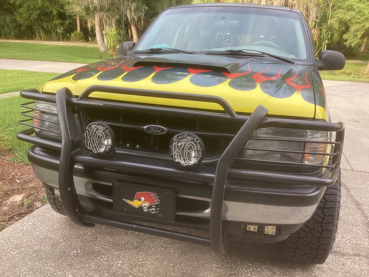

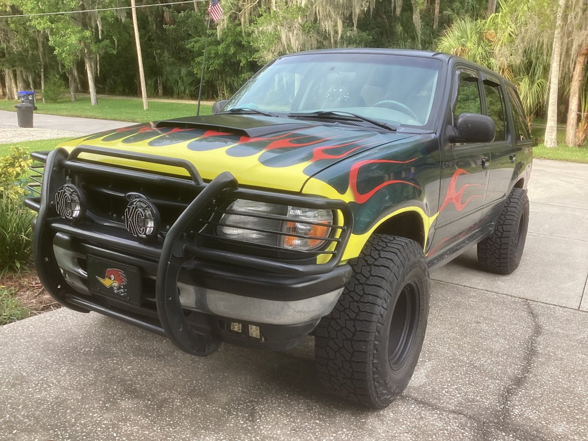

Since you asked, and so that my efforts may help others:
This is my third hood scoop attempt. The first scoop was small, and I thought it would be just fine. But it ended up looking like a mail drop box
sitting on the hood. It did not fit the lines of the truck and did not look good. The second scoop was medium sized, which looked OK but not great. Lesson: avoid small scoops on these trucks.
This scoop is from “Mr. Hood Scoop”, and they are seem to still be doing business. Mr. Hood Scoop was very kind, and strongly recommended the largest scoop they sold. So this was it: the largest scoop they marketed for the Ford Explorer. Really, it is somewhat of a universal scoop offered for several vehicles. The scoop had forward wings/fins that I did not think were attractive. So I cut off the forward wings, then removed the grill inset as it no longer fit after deleting the forward wings. I was not sure if my cuts were precise enough, so I added black plastic door molding to the leading edge. This resulting in a more certain front edge.
To mount it, I made measurements and precisely centered the scoop where I thought it would look best. A Custom Hot Rod shop advised me to also eyeball it, which surprisingly led to minor adjustments from the strict measurements. Then taped the edges to mark location on the hood. Finally, made a template out of cardboard to show where the bolt holes were, marked the holes on the hood, and started drilling. Or you could tape it the dang thing on, but I could not stop visualizing the scoop flying through my windshield at 70 mph…
Painted the scoop black, largely per the advise of the Custom Hot Rod shop… they advised that my existing flames could make the scoop look like an afterthought if I painted the scoop OEM body colors, Black, they told me, would not present any trouble with the existing flames. The Custom Hot Rod shop was right.
After mounting, I discovered that my cuts on the fins and deletion of the grill insert resulted in an unstable front edge on the scoop… it flapped like a bird, even at about 40 mph. After some consideration, I found pvc sprinkler parts to fit: two wrench on style end caps that fit nicely between the hood and the scoop. Needed two. Screwed them both to a board, then cut them with a chop saw. Screwing the pvc end caps side by side to a board allowed for precisely equal cuts on each cap. Painted them black with plastic spray paint, and used two sided tape to fasten below the forward edge of the scoop and to the hood. Heating the two sided tape with a bbq lighter made the tape stick instantly, but had to be careful because only had one try. The black color made them disappear under the scoop. And the result was a rock solid forward edge on the scoop.
Then, after a few weeks, I noticed that the scoop edges must have vibrated or produced extra pressure in a few locations, and this was slowly wearing though the relatively new paint on my hood. It was even causing the hood paint to move out from under the hood scoop in small waves. Very odd. So carefully added a line of black 5200 sealant to all of the scoop edges where the scoop met the hood. This made the connection between the scoop and the hood almost bullet proof, and the issue of the hood paint was resolved.
Used a step drill to carefully place large holes in the hood, under the scoop. Used a wire to gauge depth so to avoid drilling all the way through into the scoop.
After getting it all finalized, I am very pleased with the result.
(Sometimes I think about adding LED lights under the scoop, or a moon visor. But it is always something….)
Take care, and drive safe my friend.

What are the actual chances I was looking at a Mr. Hood Scoop scoop the other day...? Hahahaha. And, what are the chances I was sending pics of your Explorer to the gf that same day as well!? Small world. Love the flames, I was wanting to do some ghost flames or something myself, we shall see.
That was very enjoyable (and frightening imagining myself in your shoes) to read. If I did a scoop I'd consider making it functional more than not.. I don't think a snorkel is necessary, but I do find myself balls-deep in mud, water, ice, a lot of the time where I go out on my trails... I think hood height is about fair for "you probably shouldn't be going submarining in your truck and expect nothing to break" for a large splash or two or seven. So I'd totally justify it to myself to make a scoop functional on my Explorer for that sake lol.
So, do you think if I glassed / epoxied it to my hood before my inevitable repaint, I wouldn't run into those issues? I've read up on riveting it then filling it, that works very well too I've seen.
I'm glad you seem to have proven my theory and that I'm not crazy.. Little scoops look totally weird on these hoods. Gotta get just the right one looks like!! So if and when I do, I'll make sure to go to either Mr. Hood Scoop or get one that is identical in dimensions and angles/curves, ideally. Thank you so so much. I had been, like I said, looking at your truck for inspiration and detail and then here you are! Can't thank you enough seriously. I really appreciate the info [:
Some scoops lend themselves to rivets, with the lower edge turning outwards from the scoop. Most scoops, though, have lower edges that turn inwards, under the scoop. It would be very tough to use rivets to secure the Mr. Hood Scoop unit, as the mounting edges turn under the scoop. So you would have to rivet from underneath the hood. And the hood structure underneath is not flat. The under side of the hood structure has a support that would be very awkward and difficult (probably really impossible) for rivets. But you could achieve the same results with small bolts. And bolts would not show up top as the bottom edge of the scoop turns in, or under, the scoop. The Mr. Hood Scoop is probably designed to be taped…
Good luck with your project!!!
