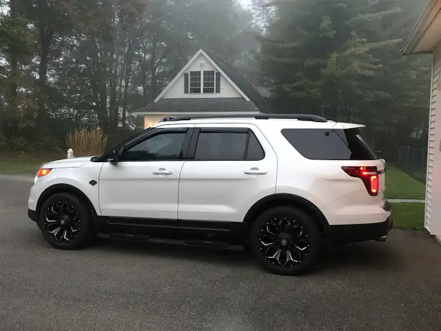

For what it is worth, I went with a 22" wheel and was able to stay within the ~3% total diameter difference by putting on a tire with a smaller side wall. During normal driving I can't feel any difference in the softness of the ride. Only when hitting potholes or major bumps does the larger wheel with smaller side wall produce a less smooth ride.
The weight of the 22's is more than the OEM. Not sure how much more since I've never weighed either. I've had the 22's on for 4 summers and over 27k miles now. I switch back to the OEM wheels and winter tires each fall. So far no issues with added brake or suspension wear that I know about. Had my rear brakes replaces at 89,500 miles and will likely need to get the fronts replaced this summer with about ~94k miles. I will also need to look at new suspension since I noticed the back is starting to leak a bit.
Looks good! What are your wheel/tire specs?

I knew someone would ask and I wouldn't have the answer off the top of my head. The winter wheels are still on due to this horrible spring. If my memory serves me correct they are the Niche Intake Silver machined wheel wrapped in 265/35/22 Yokohama Prada Spec-X. I'll try to check tonight when I get home and if I am wrong I'll come back and correct my post.
I confirmed over the weekend when I swapped wheels. I have 265/35/22 on the after market set. I set the OEM and after market next to each other and the aftermarket was a bit taller, but not much. As for weight different I used the very scientific 'pick each wheel up' method. I couldn't really tell a difference which makes me think they have to be close to the same weight. I'd think the after market weights a bit more since there is more wheel and less tire.

Diameter difference is -2.5%. 255/50-R20 vs 265/35-R22 Tire Comparison - Tire Size Calculator | Tacoma World This means you will be going a little slower than what the speedo indicates.
