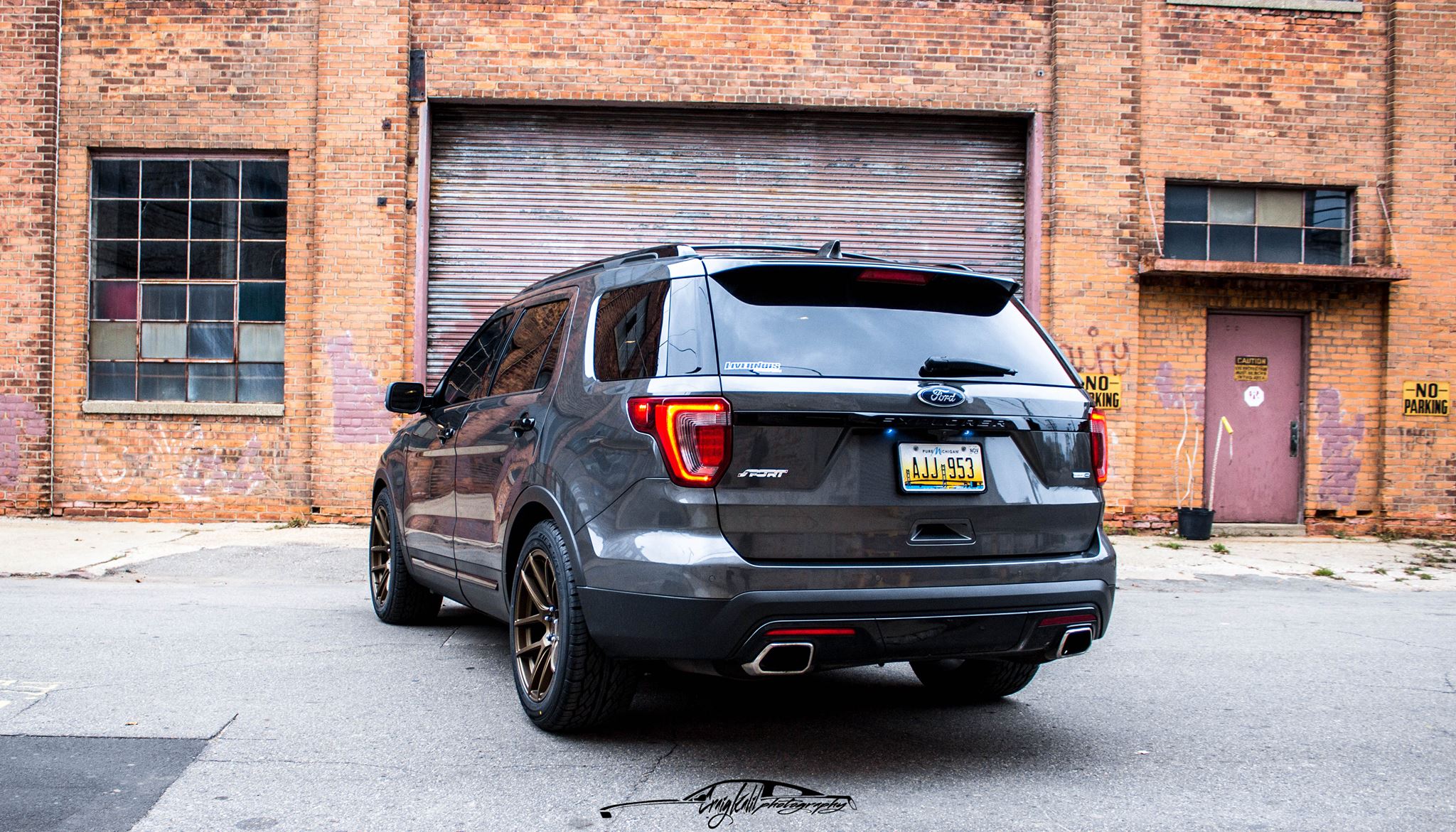

I’m running 295/45/20 on 10.5” wheel. Lowered on H&R Flex Springs
22x10.5 +45 offset on all four corners. Running a 295/45 r20. That's the widest possible tire you can run without rubbing. I have 0 clearance issues at all even at full lock. Also im running H&R Explorer lowering springs.
the velgen wheels on the picture are 22" or 20" ?
