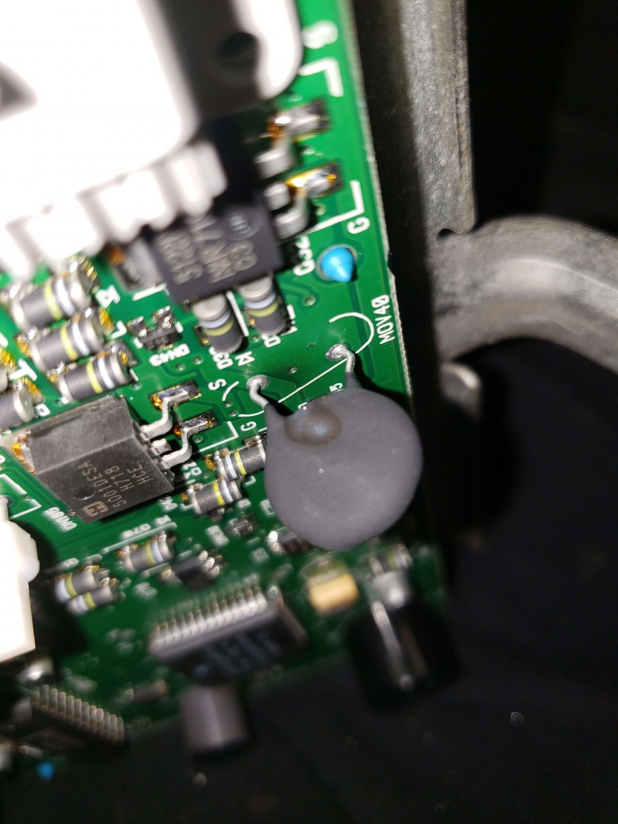

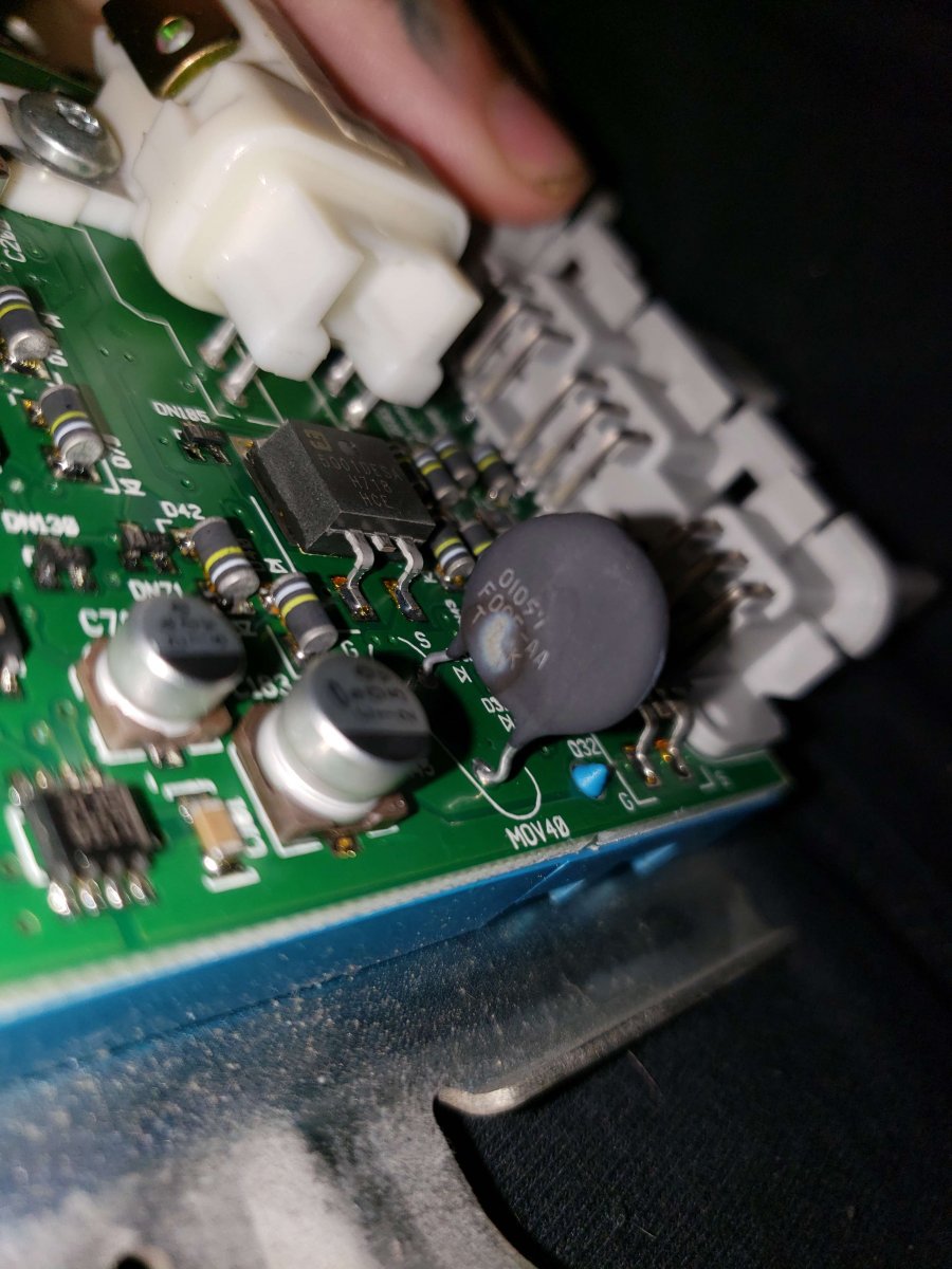

I have some new info!
With pictures!
This is the component that died. Unless that large ?capacitor? in the white plastic housing is also dead but I doubt it. I may be making a bold claim here saying that but... See pics
Going to re-solder this if I can buy a replacement and see what I get. Ideally won't be using this module anyway, but having an emergency extra is not a bad thought if it actually work, since if it happened once, it is more probable to happen again.
Rest of the board appears ok, no burned traces, no melted solder, no burnt components, nothing visually obvious. Visual =/= tested, though, but I want to start here if I do go through with the resoldering of this component. I have little hope, but this is for science.
Drove the truck today, didn't shut off randomly. Made sure to make lots of left turns to try and replicate what GF experienced when she was driving. I wonder if maybe this component got damaged and then upon ?power surge from alternator working harder?? (I know that's a thing but it's supposed to be regulated.) that the left turn finished it off because it was no longer operating correctly.
I don't know a single thing about this board because all I've done thus far is open it, take pics, smell it a lot. I'm sure this is probably part of a regulation circuit; resistor; etc or something designed to limit power flow and then fail as a fuse sort of component.. Visually I'm seeing this is a capacitor but not all things are always as they appear. I only think so because that is usually the order in which things fail in a burning fashion, that part of a board should be first and then that part of the board should theoretically fail first of the issue is too much power, such as from a jump gone wrong. And ideally, it didn't let power get past it, if my uneducated assumption is correct. I hope it did its job and I can see the module work again, just to know it is possible, for anyone out there who may need that info as a resource. To be continued!

FWIW the burnt component looks like a metal oxide varistor aka MOVistor. basically a surge supressor. They are typically a disc shape just like a capacitor. The MOV label on the pcb is a clue.
