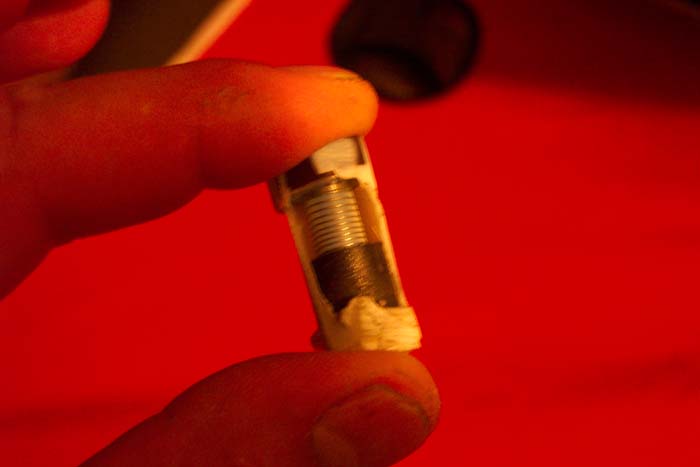

why do they need to be perfectly level and straight?? If that's the case, wouldnt the airbags go off if I parked on a hilly driveway??
I will most likely just put shims on the one where the panel is bent in order to get it as straight as I can.

I am attaching a photo of an air bag sensor. This is the most common type. Ford Explorer uses a simular system. The spring is very calibrated. Upon impact the sleeve sleeve slides forward and connect the two contacts and BOOM. Bags go off. 1/100th of a second they inflate and deinflate.
It is all based on inirtia. You have to stop suddenly, very, very suddenly to set of air bags.
