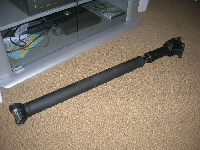

Cool thats what I wanted to know before I have them build it tonight, I'll go with the normal just U-joint style. Just was curious cause had one built for it when the first OEM shaft went out when it was AWD and it vibrated so I was curious since this time it wont be loaded because its not AWD anymore. :)

New shaft is done :)
