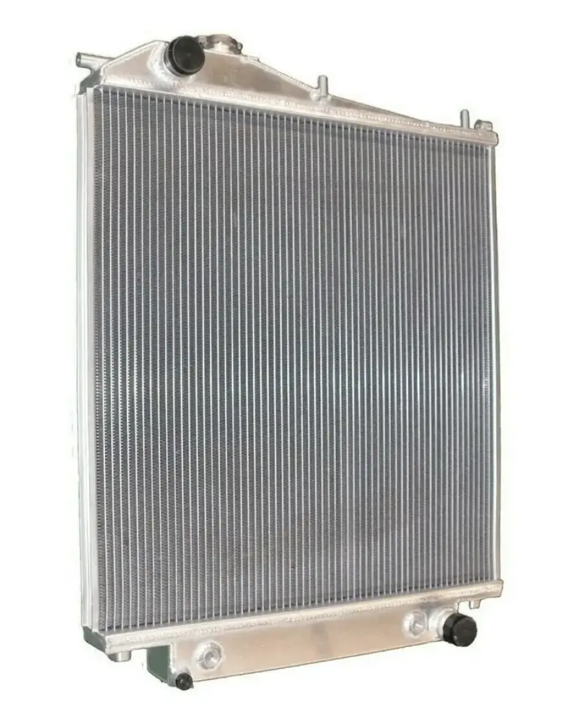

Has anyone tried this kind of radiator? Any comments are appreciated!
Ebay
3ROW All Aluminum Radiator For 2006-2010 Ford Explorer 4.0L 4.6L HPR906-3R11
Haven't tried one. Don't know of anyone that has. What's the price on that gem ? The aluminum core plastic tank radiators work very well. They are good for 20 years with regular fluid changes and cleaning the outside of the core. Are you trying to solve a problem ?

My theory on the OEM radiators failing is it is due to them running at 20 psi. I recommend using a 16 psi cap since there appears to be no change in cooling performance from doing so. I and many others here are doing this. So far after a year with the 16 psi cap I haven't seen the temperature increase even a needle's width on the cluster gauge. Even in 100+ degree temperatures with the AC running on maximum.

The tanks can get a hair line crack where they are crimped to the header. Very hard to see. They usually only leak when hot with pressure. More likely that than the gasket itself. Very common on all plastic tank radiators not just Ford. Yes 20 years is easily possible with proper maintenance. I used to own a radiator shop and can tell you the the amount of bugs and debris found stuck between the fins and tubes can be crazy. Nobody ever thinks about cleaning the radiator, well maybe off road mudder guys do. With today's prices replacing tanks, gaskets and labor.. You might as well start doing a search for a complete unit. I replaced mine, 2000 Sport about a year ago. I was going to replace both tanks and gaskets until I got prices on parts plus shipping.. I have the tools to do it myself. It wasn't worth it. Found a brand new OEM unit on line for $120.00 Free shipping.

They are typically used in high performance applications. Doubt it would be needed in any stock vehicle. Couple of f other things to consider, how many FPI, are the fins louvered, how many rows of tubes...

The main reason I am looking for an all-metal one is, to avoid the plastic tanks. The price I linked above is even lower than that of plastic-aluminum one.
I've had the all aluminum units fail in the same typical spots the plastic ones do. I've had the all metal ones fail in 6 months and the plastic last 15 years.
