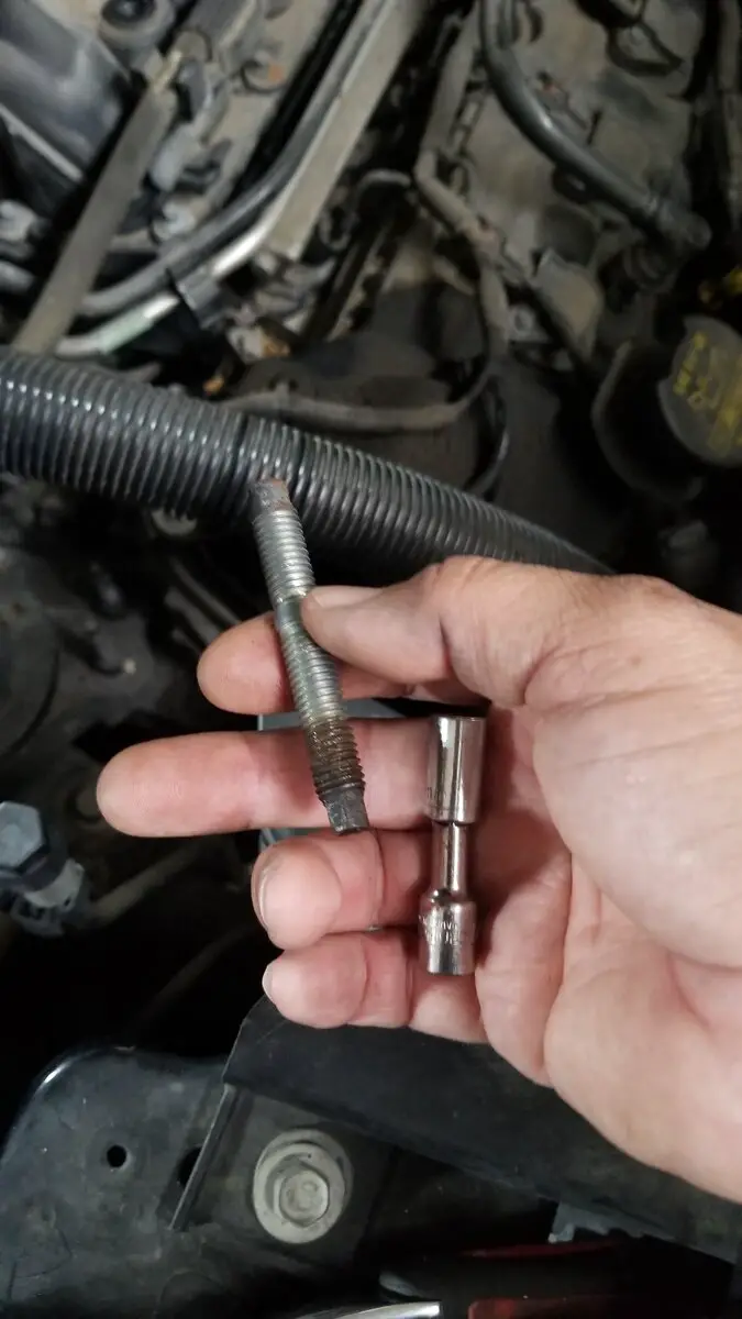

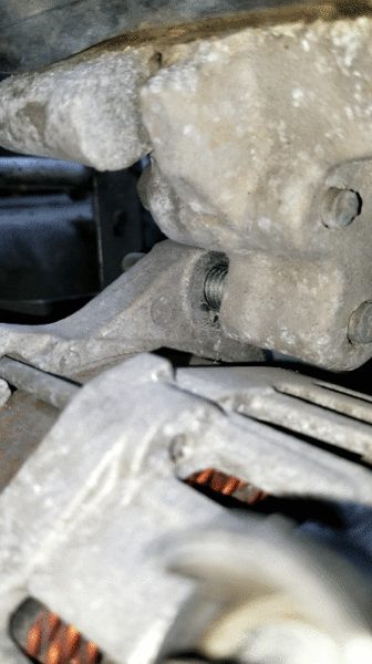

I haven't found other posts with much detail and I'm running into an issue which is preventing me from removing the alternator.
2011 Explorer Limited 4WD V6
THE ISSUE: The top bolt is actually a nut, which I have removed. But the "stud" or threads is preventing me from removing the alternator. One post in this forum says to remove the "stud" but, .... how do you remove it?? See attached file for a pic of what I'm referring to.
So far i have:
1) Removed Air Intake
2) Removed the cooling fans.
3) Removed the tensioner (only because i broke it and needs to be replaced)
4) removed bottom bolt and top nut
5) Removed wire harness and wire.
Everything is disconnected.... this last issue is stopping progress.
You need a 9:30 seconds wrench it'll fit right on the end of that stud and you just screw it out
