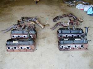

The bolt patternare are the same look up exhaust gaskets, I just bought some for my TMHs , just dif size ports BOLT holes are the same, there must be someone that have tried this.I am sure it is just the angle of the plugs and
jt thomas: Mustangs are not Explorers. Explorers are not Mustangs. Two totally different vehicles. The routing on the primary tubes on a Mustang header all go on a DOWNWARDS angle BACK. On the Explorer, a MOST of the tubes actually go UP, then BACK, then DOWN. That gives the rest of the primaries room to clear the plugs.
I did find ONE problem...I need to find a `96 Dipstick tube...it had a slightly different shape to clear the spark plug.....
OR I'll run a Lokar dipstick...

what heads are they looks like the spark plugs clear the tubes better then the GTP do
Spdrcer34 What camshaft do you have. I am going to try a comp cam 35-512-8 in my 2000 MM D- driver
Those are Trick Flow Twisted Wedge Heads.

I ws thinking about bending it towards the #8 primary, then cutting and welding the 'tab' to secure it to THAT bolt, but I figured it would look like crap, and I bought the Lokar dipstick yesterday.
Eventually I will have to buy one for my 4R70W to match...
Does it ever end?
Ryan
Lokar dipstick tube installed....

I haven't started the engine yet, but I am going to have to keep a pair of Mechanix gloves in the glove box in case I need to check the oil when the car is still hot. The handle is made of aluminum..and it is within about 1/2" of the primary.
