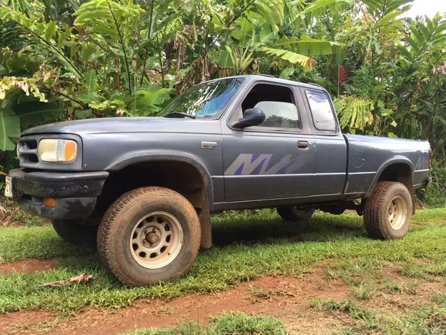

I bought another cheap truck yesterday! It’s a 94 Mazda B4000 4x4, 5speed, 3.73, 4” lift, great condition 31” AT tires, 156,000 miles.
Things that don’t work: 4wd, power windows, power seats, power mirrors, radio.
Needs an intake tube, has a gas smell. But it has current registration and inspection, and I drove it home!
Paid $300.

Fuel smell is usually canister purge solenoid is out and charcoal canister is full of fumes
Yeah, this one’s not gonna sit around! Plan is to get it running good enough ASAP!
Good tip on the purge valve, Jamie. I will check that. I’m guessing it can be tested? Can’t find it mentioned in my book.

The canister purge you can apply 12v to it and listen for it to CLICK = open you can put air or vacuum through the line when you do this to make sure its opening/closing

the computer "dumps" the fuel by opening the injectors fully and for longer = it gets burned out the exhaust....hopefully! When I say dumping I dont mean like puddles forming on the ground :)
The raw fuel smell is likely from the canister purge solenoid / charcoal canister
The charcoal canister is still under the hood on that 94, later they moved them back above the spare tire....stinks less back there LOL
They get old and stale, stink all the time.
The purpose of the canister is to hold the fumes from the top of the fuel tank until you hit WOT with the skinny pedal, then the computer tells the canister purge valve to open and all the fumes/vapors from the charcoal canister/ and fuel tank and burned up through the intake. WOT + canister purge opens = intake vacuum sucks vapors off the top of the tank and canister right through the throttle body.
If the canister purge quits working, well then the vapors just sit under the hood in the canister = raw fuel smell stinks
If its worse when you exit the highway and come to a stop, I got $5 says its a bad canister purge valve
Does not hurt to replace the charcoal canister too if it stinks all the time
Pretty sure Rick just had to replace his on the pumpkin earlier this year....same thing smelled like raw fuel

Checked codes yesterday, only active koeo code is 565, canister purge valve circuit fault, did you call it or what!?
Guess I’ll replace it.
