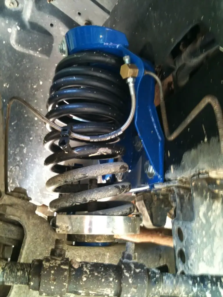

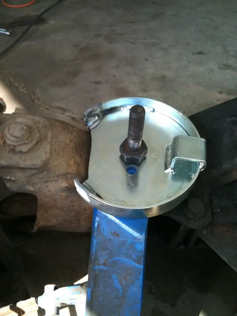

I'm using the JD new upper coil buckets and then their lower coil seats for the early bronco. They have to be modified slightly to work on the D35. I had to drill a hole in the center for the bolt and then notch it to fit around the part of the beam that goes up where the ball joints attach the knuckle.
I then used Moog springs for a stock early F150 to get the softer spring rate. If you used a setup similar to this it would allow you to use any of the early bronco/F150 springs.
It flexs good enough for me.
