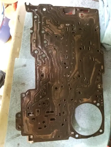

Here is what my valve body looked like before I installed a rebuild kit. The material in the passages reminded me of the copper stuff in that Bar's Stop Leak. Very fine particles.
I'm thinking that it is band material and the bands need to readjusted?
@lmarkie74
There is always "bronzy" looking stuff deposited in trans. fluid. Usually you can see it in the drained fluid making it sort of shimmer as it's swirled around.
I've always suspected it comes from the clutch plates; there is far more surface area involved there than the bands. It can't hurt to readjust the bands, simple procedure. In fact, on my 5R55S, there are two different procedures listed for the O/D band: back off 2 turns for cars, 1-1/2 turns for trucks. I did the 1-1/2 and it eliminated slight slippage I was feeling in 5th. gear. How long? It's been over a year now.
BTW, specs are identical regarding rebuilding the W and S transmissions. imp
