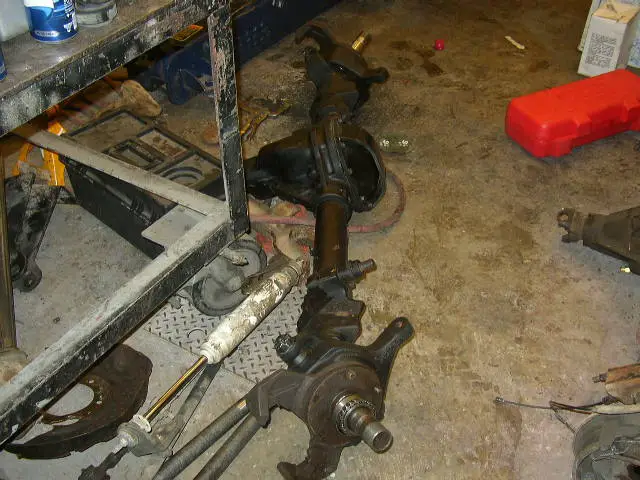

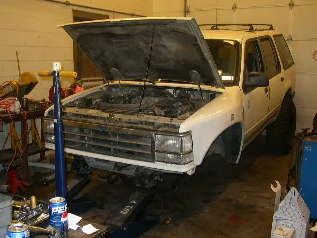

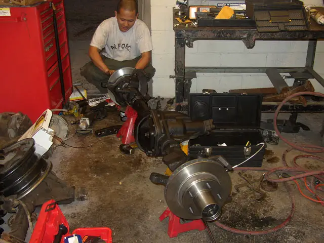

Day 1: after 3 hours, we finished taking the TTB front end off.
end of day 1.

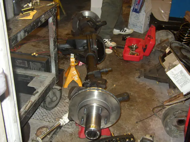

Day 2 and 3: this is where I wished I got the front end put together before taking everything out. I had about 6 spindle studs missing. Nobody in town had them and finally decided with a grade 8 bolt from ACE.
who tried to put the bearings in backwards?:eek:
done, minus the calipers and brake lines.
old tires, mounted and balanced on new 15x8 rims.
Day 4 and 5:

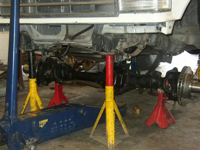

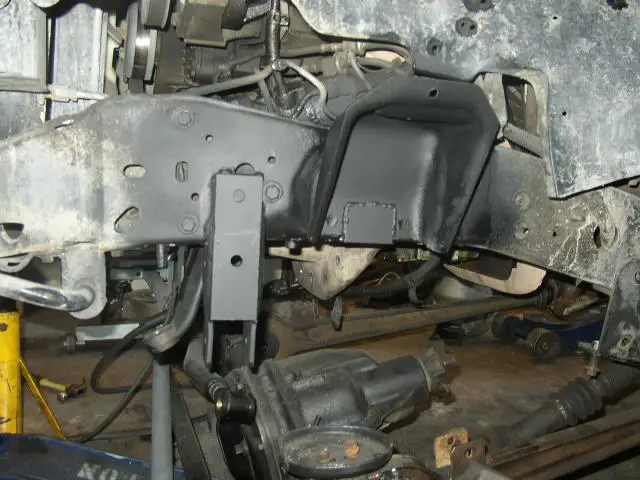

-got the front end under the explorer.
-worked on the transmission cross-member, it was on the way of the RA bracket.
-radius arms and brackets hooked up.
I had to cut the cross-member and weld it with the RA bracket. This is temporary and hopefully soon I can build a modified one with tubes.

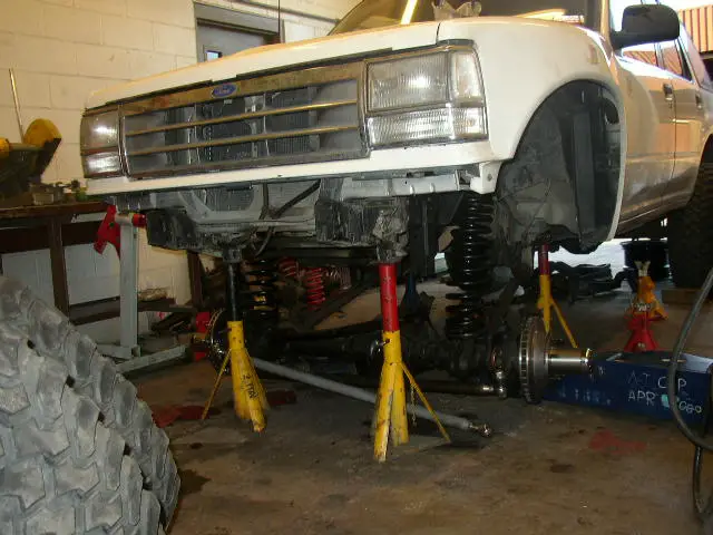

Day 6 and 7:
-I had to cut and reinforce the fullsize upper coil bucket and did the tie rod.
-got the coils and track bar installed also.
track bar drop bracket and coil bucket welded in place.
this is the unpainted coil bucket. You can see the booger welds from the previous day.
newbie welder... getting better?
end of day 7...

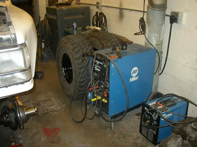

What type of welder are you using, welds look good I think but I'm not a welder. I just started, learning with a Lincoln Mig 210 that my engineering department has for our senior projects, my welds don't look quite that good. Mine usually look more convex instead of nice concave stacked dimes like yours. But they are getting better. Anyone have any good welding tips?
Originally posted by Byrd91
What type of welder are you using?
I'm using the 70's era Millermatic 35 :D. As long as it's a 220V, it should do well and just practice... work on your settings too.
here's a pic...
