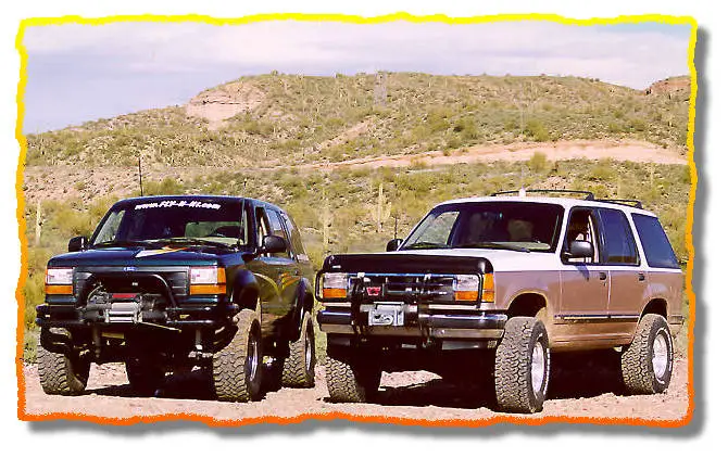

Kvo has a Ramsey mounted on his pre 95. It is mounted on a TJM bumper. Here's a picture of his setup.

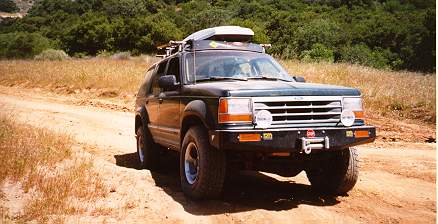

Here is Rick's old setup and Jack Lobdell(he has a Warn)
what I'm looking for is a way of installing it without too much of playing with my front end. I want to put it on top of the frame right in front of a radiator. That would push my bumper a bit but that's OK. Looks like a set-up that Rick has had on his rig would work the best. See, I didn't want to loose my bumper and my push bar.
Someone on this board with a ranger made some brackets to mount his winch right behind the stock bumper and he cut out a hole in the bumper for the fairlead. Here's a link to his pictures: http://albums.photopoint.com/j/AlbumList?u=1153055&Auth=false . I don't know if it would work with your though, since you have a bodylift. You would probably need to make some other brackets to lift the winch up.
Well, that's Kampy's rig. I just wheeled with him a few days ago in Attica. I did get a chance to look at his set-up real close. That's what gave me an idea of putting my winch right where he's got his.
