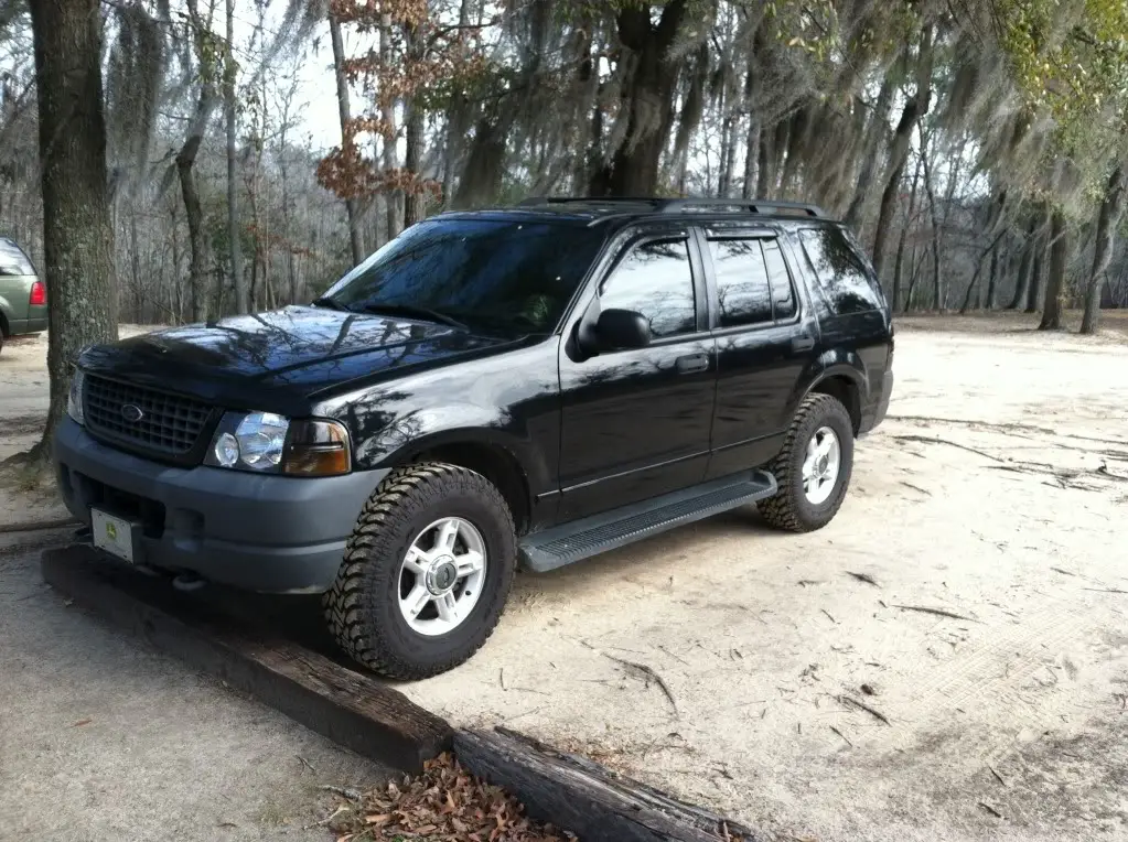

That's mine at stock height with 265/75 16s
No rub even at full lock.
Ok, that does look good actually. So has anyone gone larger than 265 tires on a stock truck? Basically what is the limit on tire size for a non-lifted explorer (05) without rubbing too much? Just curious and also wondering how I can get rid of my tires for a decent price now that they are almost brand new and I want to get a larger size. So what is the opinion on size of a spacer lift without having any issues with joints and half shafts wearing prematurely? I am thinking maybe 2.0" front and 1.5 " rears but I am thinking no body lift. I also have to fit this into a normal garage door with the possibility of a roof rack later too.
265/75/16 is about the limit on a non lifted truck AFAIK. If you want the least wear from a spacer lift go really small...like 1.5/1 or 1.25/1. Or just do the 1.5" body lift and you'll have no issues at all.
