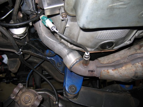

in my BII I have 98 5.0L, TM headers, 98 5.0L explorer down pipes (modified the drivers pipe slightly to clear the mustang style dual sump oil pan and front TTB driveshaft), and then a dual inlet single outlet muffler.
Using the stock 98 5.0L down pipes after the headers gives you the 4ea 02 sensor bungs and the primary cat converters.
It is them very simple to run a Y pipe or a dual inlet muffler right after the factory 5.0L pipes and finish the exhaust how you choose.
On a Gen II to use the factory 5.0L down pipes (like I did in my BII as described above) in a Gen I truck with the TTB front end you have to modify the d side to clear the d shaft and trans bellhousing as well as Mustang oil pan.
You will not be able to use the stock 96-2001 5.0L explorer oil pan in your truck, it is notched for the Gen II IFS, so the pipes and cats must be modified a bit
Pictures of all this are in my BII conversion thread, towards the end.
Should be identical to what you are looking to do.
