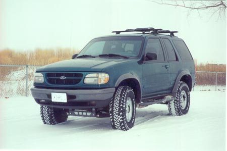

On mine, I fit 285 X 75 R16 (equivalent to 33"+ X 11.00") onto the stock rims.
I love it! Except the front driveshaft problems

Sweet looking truck DJohnson!! I still yet to get the front driveshaft. I have to get a hold of the guy building mine. After the snow we have been getting up here, i'm going to need it pretty soon. Plus, I will need to get some all terrains put on and not the mud terrains. They are sliding all over the road. Keep up the good work.
