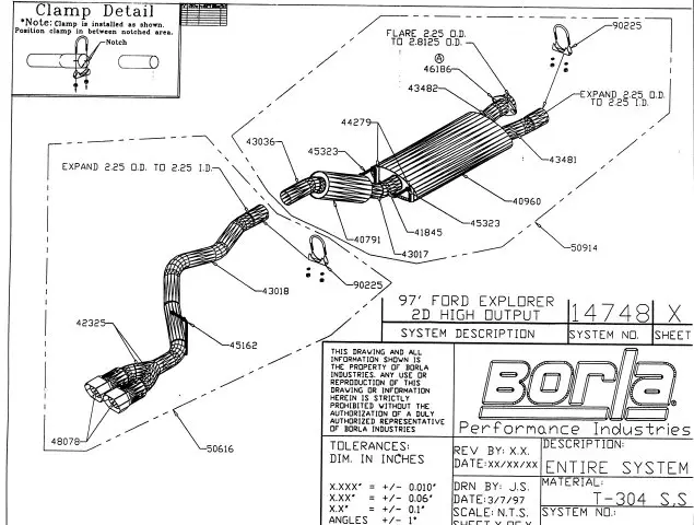

You mean like my Borla on my '97 SOHC Sport?

When did you get that? When I e-mailed them about a cat-back, they said they dont offer one for the two door late model sports.
Hey buddy... that looks nice...
a few q's
How loud is that sucker... is it raging flowmaster super loud, or is a mellow deep soothing 'loud'?
performance gains... were they tangible?
are you running dual in single out?
how much did it cost you?
:D Thanks
Nate
I think I got it 2 1/2 year ago from Performance Products. Here is the Borla drawing that came with it. They might not have had enough demand for it to continue building it. It is not loud at all, but you know it's there. It doesn't wake up the neighbors when I leave for work at 6:00 in the morning.
It must be no longer in production because I have checked their site along with all other major exhaust manufacturers and nothing is in production for our '97 and later 2 dr SOHC dual inlet single out Explorers. Gibson appears to be the closest with their exhaust that is made for the single inlet stock mufflers. Like I said, you are better off going to a exhaust shop and having one custom fabricated with a nice Flowmaster muffler. They are about $100.
thats wierd, why do the two inlets connect differently to the muffler, even on the factory setup? the left one seems bolt on while the right one slides over and welded or clamped. whats the reson for this?
was that borla kit bolt-on? did you do it yourself? any welding involved?

The one pipe is connected by two bolts so that it can be removed when changing the transmission filter. the 'U' bolt clamps usually can't be reused once they have been removed. Ford probably figured that tranny lube places wouldn' t have the 'U' bolts handy after they changed the filter. Another possiblity is maybe they were afraid someone would try and accidentally install the muffler upside down.

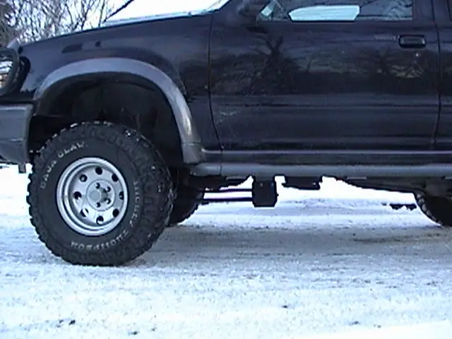

Here are a couple of shots of the torsion bar drop brackets on my Ex from the Trailmaster lift. As you can see, its not that bad. At least not to me. I dont do any rock crawling so getting hung up on the underside is not a worry to me.
