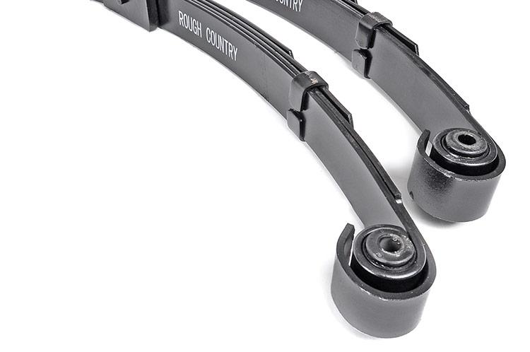

When the main leaf of a multispring pack breaks the axle shifts unless it was built with a "military wrap".
This was just posted in our Facebook group a short time ago. Multi leaf pack with a broken main spring...
Except for the sagging, I never had a problem with my monoleafs. The ARB old man emu springs came with the "military wrap" style eye so I'm confident they will provide me with may thousands of miles of use.
