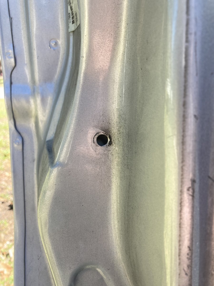

This is what I did, I’m not very savvy at these forums so I hope my pics post with my reply here. I had to take the door panel off to get to the inside where the actuator is, and I simply held it up in place with the stud sticking through the hole and drilled an 8th inch hole right below where the stud is. I was very careful not to drill more than about a half inch in because once you’re through the bracket that is holding the actuator, you might accidentally drill into the actuator. So be very careful drilling through the door frame through the nylon bushing into the bracket through the bracket and that’s as far as you want to drill. Then I used a #8 sheet metal screw 1/2 “ and threaded it in and it’s holding the bracket very tightly and of course everything is working like new now. I did not have to remove the window bracket, that I have seen described in other posts. And since my bracket was still on the actuator, the only thing I had to do was to drill the hole, put the screw in to hold the actuator in place like the rivet used to. Good luck.
