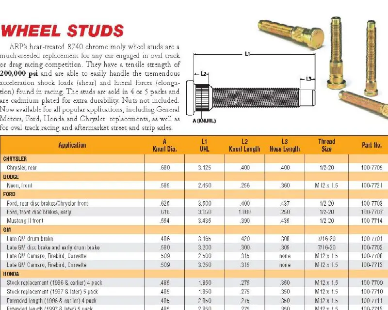

LUG STUDS:
I got an email back from Moroso. They say they have studs for my application, but they are racing only, not for street, whatever that means. I spoke to ARP, and they were very unhelpful and couldn't help me with sizing, I'm going to have to measure myself. They ok'ed their street use, but they are "very long".
Should I get longer ARP studs and just use longer lug nuts? I would assume ARP would make the strongest studs in the world, and if I got the pricing right, they are only $13 for a 5-pack! I saw Ford Racing has some 'Stang racing ones for $100!! What's that all about??
Or, does anyone know where I can get simple replacement ones? I saw in "The Definitive Wheel Stud" thread that they are extremely difficult to find. I feel like I'm falling in that trap right now.

Got my parts ordered. Thanks for the partsamerica.com link, but after I figured out DORMAN's part number (610-368), I was able to find them on rockauto.com and I favor them. Not so hard to find after all. Cost me $6 and change for 5 studs.
